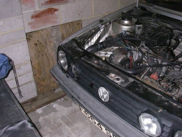

The 1.8 GU motor is out, along with the rod-change gearbox.  It's being replaced with a cable-change gearbox from a Rallye and a 2.0 motor from a Passat.  This upgrade will take it to fuel injection, which necessitates an electric lift pump from a Rallye in the tank and a pressure pump where the GTI has one, too (among other things!).  These aren't the scary part of this conversion.  Due to the 4WD system, there isn't enough space for a proper downpipe on the Syncro.  To get round this big issue I'm going to be (gulp) cutting a section out of the tunnel and basically making a clutch foot-rest which will give the downpipe the space it needs.
