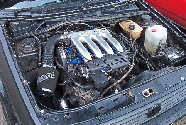

why would you fit an abf then put all the sh1t usless kr crap all over it
to get an abf ( inc abf loom etc ) to 170bhp is a piece os p1ss
my old c reg mk3 1.3 that i 2.0 16v abf'd
stock engine , induction filter , 1.8 16v kr cams ( gives overlap on valves compared to stock abf cams ) de cat , scorpion exhaust , magnax 4 branch , ecu chip produced 174 bhp @ 5800 rpm & 159 ftlbs tork
( unfortuanatly car was written off by a mate i sold it too , so i fitted the engine to a lads car from sunderland below)
currently building a mk2 track car for a client with abf for next years racing season should be up near 200 bhp n/a
will also be building an abf turbo polo classic saloon next year for our own road leagal track toy
the blue mk2 abf would keep with impreza wrx wagons upto 115 mph .well funny also did 145mph on the toledo clocks ( using 02a cable change box)
I WOULD SAY THE ABF IS THE BEST VALUE CONVERSION £ FOR BHP GOING & IS SO DRIVABLE  :laugh: SHOULD HAVE DONE ANOTHER INSTEAD OF THE 20VT PROJECT  :cry:
