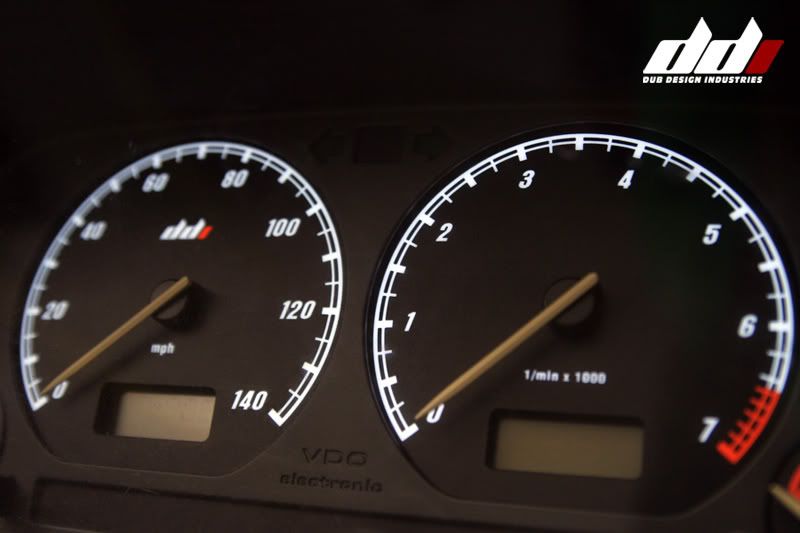

Perfect. Did you do blue or red?
Did mine blue mate but just bought these clocks...
So am gona change them to red now so they match and go for the Audi look  :cool:
