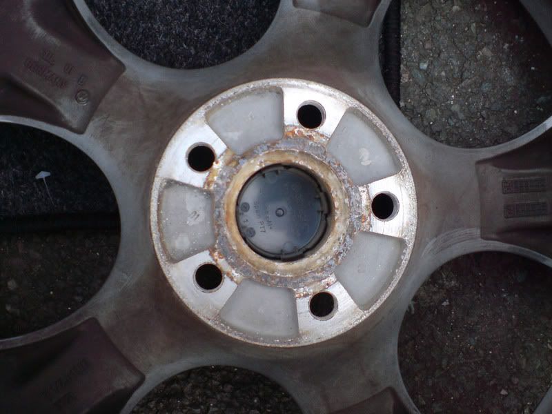

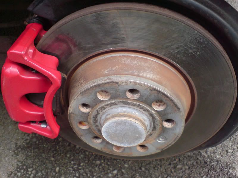

After eventually getting the wheel off with a few trusty hits with a rubber hammer after the wheel had 'welded' onto the hubs, this is what was found;
And looking at the inside of the wheel and the nuts;
So first of all it was down to rubbing down the hubs to get smooth the surface and get rid of some of the rust;
Onto the hammerite.  Trying to keep the brush marks down to a minimum;
