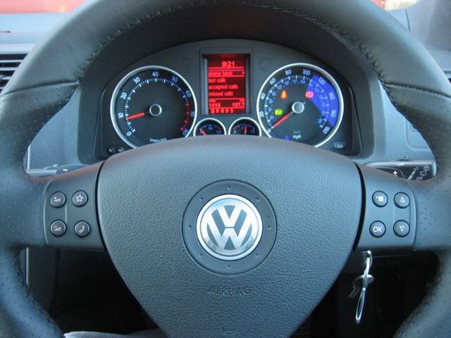

Anyway with this installed you get full voice activated dialling either just say the number, or name from phone book.  It also integrates with the display and automatically downloads your phone book to the car, so you can dial from the MFSW controls as well.

The mute button now activates the voice dialling, phone button does nothing, and OK will answer or make calls.

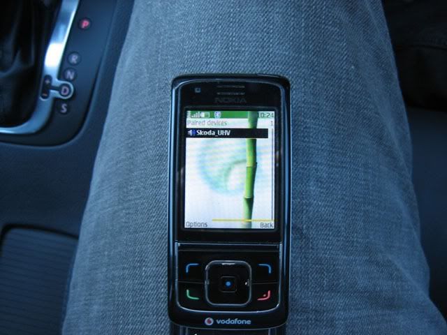

My phone, unfortunatly shows Skoda but Ho-hum small price to pay.

Any way of changing the connection name :undecided:
Surely it's only a software thing. Can you alter the setting in the head unit :undecided:

You can change the name in the phone (think it's called short name in phones bluetooth settings)
I've got the parrot bluetooth kit in my car (integrated with phone button on MFSW but no display)   I also have a parrot kit in my MKIV and both pair names showed up as parrot_CK3000 or something.   I've changed both in my phone so one now says Golf GTI and Golf TDI when you connect.

Hi thanks for the comments, I don't think you can change the bluetooth name, as you cannot access any setting in the bluetooth box, but i'm not that bothered about the name on the phone.  Used it a few times now and really impressed with the sound quality, and the voice recognition actually seems to understand what you say, which is a first.  :smiley:
I think you got the wrong end of the stick there.   I haven't changed any settings on the car, just in the phone itself.
In my Nokia you go to the Bluetooth menu, then "Paired devices", then select the device name (in your case Skoda_UHV) then "options" assign short name.   I changed mine from parrot to Golf GTI etc.  It now shows up on the phone as connected to Golf GTI.

I would however like to see the phone button utilised instead of the mute button. Surely there is a way to re-code the unit to use this button to control calls :undecided:

The problem with the phone button is that Skoda and Seat cars that have the bluetooth option have a different layout on the steering wheel.  They do not have a phone button, in its place is the mute button, and the Golf mute button is a voice button.  As far as I know there is no way to use the phone button on the wheel.  Also when the phone rings the display reads Answer or end, so you choose which option with the arrow keys then hit ok, which is more intuative anyway, and means you can easily ignore calls if you like.
