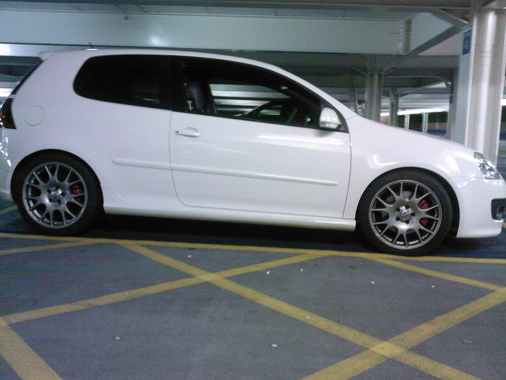

« Reply #6 on: 24 August 2007, 00:59 »
Not a very good picture, but maybe you can get the jist. More obviously lowered at the front.

« Reply #7 on: 24 August 2007, 08:42 »
Is it just me but do the Pescara's look too small for the ED30 when it's lowered?  Or perhaps it is just the darkness of the tyre merging into the wheel arch that makes them look that way...
P.S. How come the front sits lower?  Do you need to tweak it a bit?  Or is it meant to be that way?

« Reply #8 on: 24 August 2007, 14:01 »
Yeah the alloys look small, just the design i guess. Saying that i think they always looked small in magazines, but look bigger in real life. I'm wanting to get rid of them, but they  come as a package for the ed30, so will affect resale value etc.. i think. I may get some 2nd hand monzas on ebay and powder coat them black in future.
Think the rears are deliberately set higher to allow loading, ie rear passengers + trunk load of crap.

« Reply #9 on: 25 August 2007, 07:35 »
the front looks a little too low to me, is your car a dsg?
