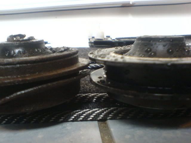

I think the bushes should be the same for all mk2's.
Did you re-fit the metal sleeve?
GSF and Febi wishbones are reported to be a bit thinner than VAG ones, but I dont think they should move about  :smiley:

Heres a few pics of the old wishbone (left) and the new GSF part (right).
You can see on the old bush there is a metal insert, this stuck out both ends of the rear bush and located in the subframe (the insert was damaged when I removed it from the subframe), but, the new wishbone doesnt have this metal insert so it can move about 2-3mm back and fourth until it hits the bolt.

I did mine recently so I know exactly what you're talking about.
There should be a metal sleeve (as mentioned above) which slides over the bolt that goes through the rear wishbone bush. I got mine from the garage that loosened all my bolts prior to me fitting the wishbones so I'm afraid I can't help you with the part number.
Ah...I broke it. What can I do now then?

Just had a look on GSF, the part number is 42270 Guide sleeve (metal) 50p!!!
Oh and they nearly always break on removal.
beaten to it  :smiley:
191 407 190 A      fitting sleeve  80p from dealers
But I would go to gsf becasue its their wishbone  :wink:

How do they fit into the subframe without bending the top and bottom though as the old one bent on removal.

You fit the wishbone first then tap the sleeve into place through the bush, it helps to line the bush up correctly and you'll know when its right as the sleeve will suddenly go all the way in.
