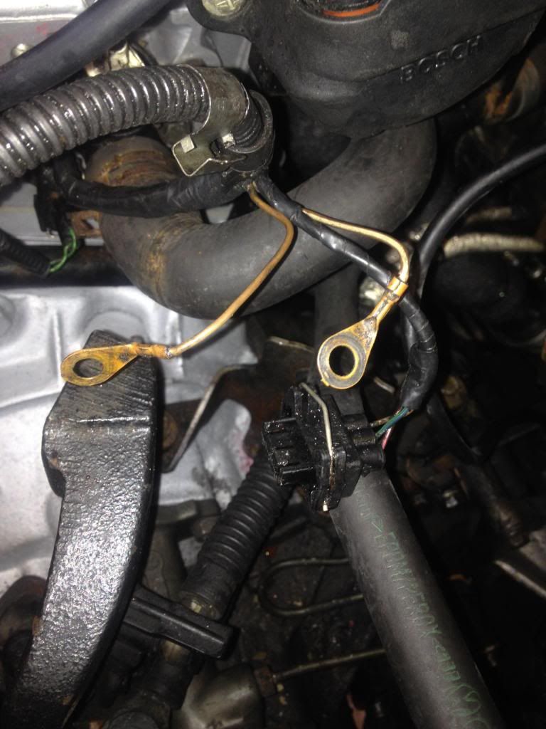

Still not back to full health but did a bit yesterday.
have found homes for most of the wiring, but am totally flumaxed with these!
Next to the dizzy connector

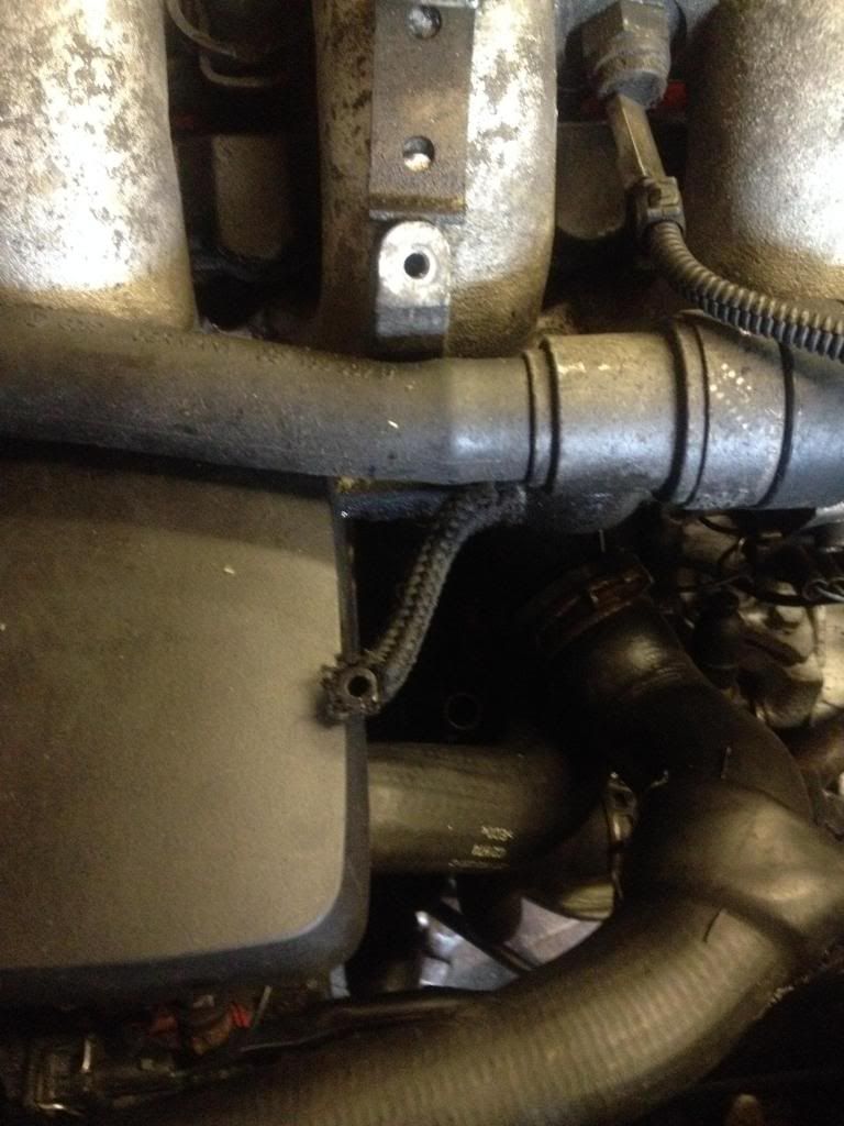

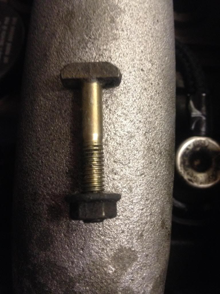

Then there is this bolt!
Where does it go and holding what?
And this little vacuum pipe?

You are correct in thinking those earth spades attach to the bracket which bolts on to the back edge of the head.

That bracket is for the earth to the coil.

Thanks guys!

That vacuum pipe goes to the pipe sticking out of the inlet manifold, in front of the throttle body.

The vac pipe goes on the black box in the pic
