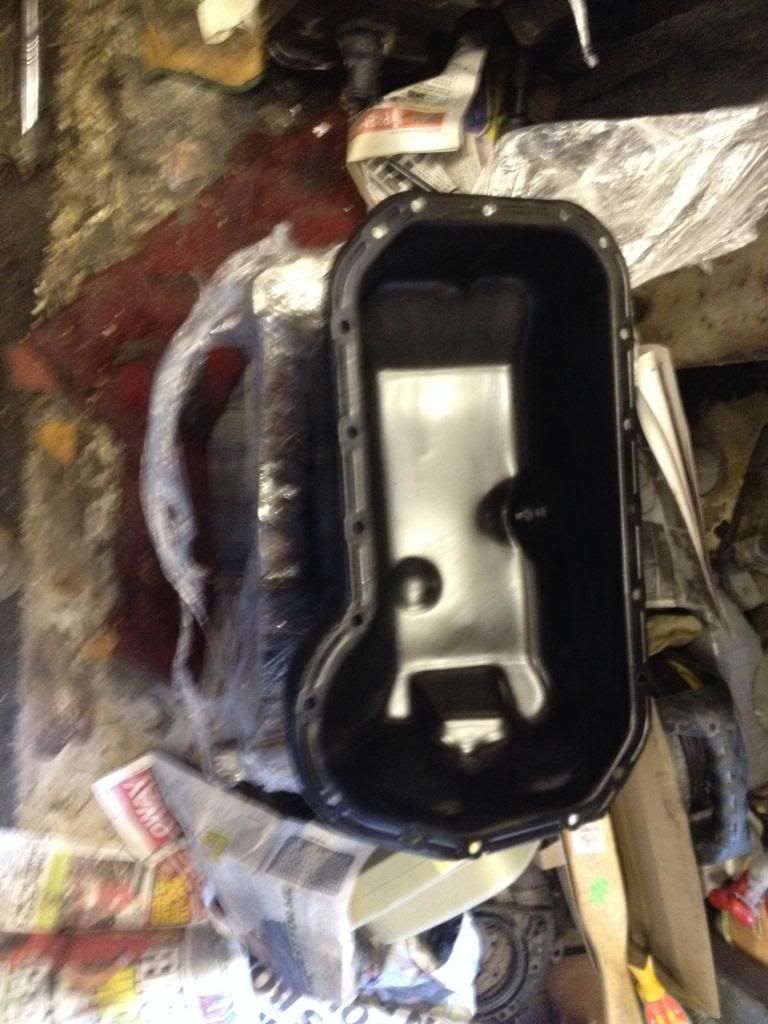

So its Plan B
Steel sump from the Diesel engine will fit and magnetic sump plug from Awesome fits that!

Hmmmm just had a thought!
Will have to check that the diesel sump is not any deeper that the ally one off the abf engine!

Whys that, road clearance concerns?
Offline Len
  • Posts: 16,292
Re: Len's Mk3 16v ~ The Rebel Car! New Wheel Pics Page 90
« Reply #1016 on: 26 December 2013, 10:35 »
Yea, we have a lot of road humps around here!

Sump will be fine!
