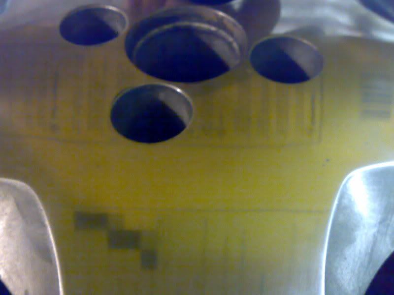

My Alloys are a bit worse for wear,  I know you can get alloys wheel spray paints, but does any one here know if they are any good?   I'm not looking for perfection but i will have to do a full respray on all four as mine are gun metal gray and cannot get a match, but i would like them a lighter silver anyway  :smiley:
