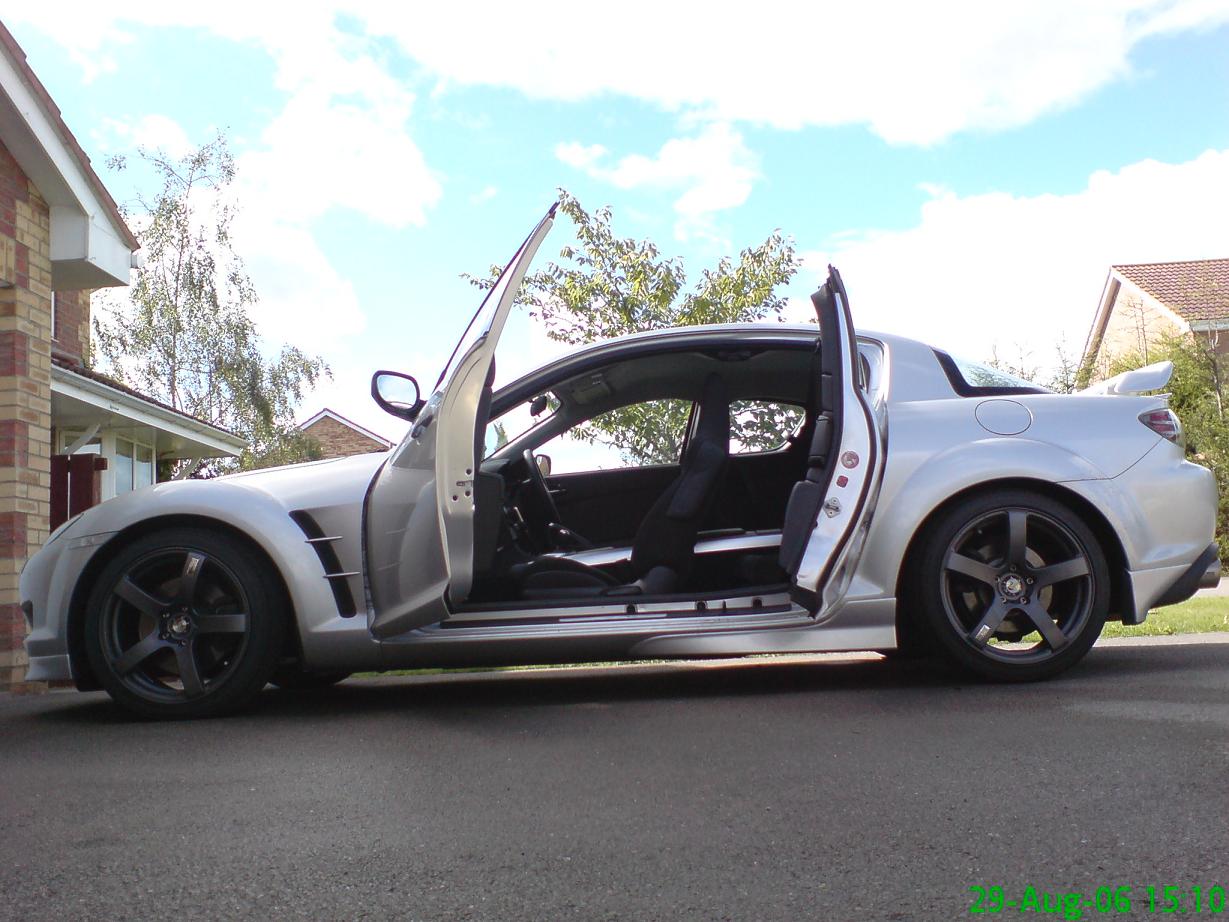

Hurdy, i think the rx-8 will be a much better drive than her punto  :grin:
Great handling car, and sounds ace with aftermarket exhaust, but constant need of refuelling takes the sting out of the joy of ownership. In its defence, my 1st year service was on £85, 2nd year £160. So cheaper than GTI i think. Here is a pic of my car showing off :smiley:
Or maybe you can get here this one:
http://www.petrolheads.co.uk/sales/160928.htm.
Saying that, your colleagues price is good, i only got 12k for mine after 2.5 years of ownership.
