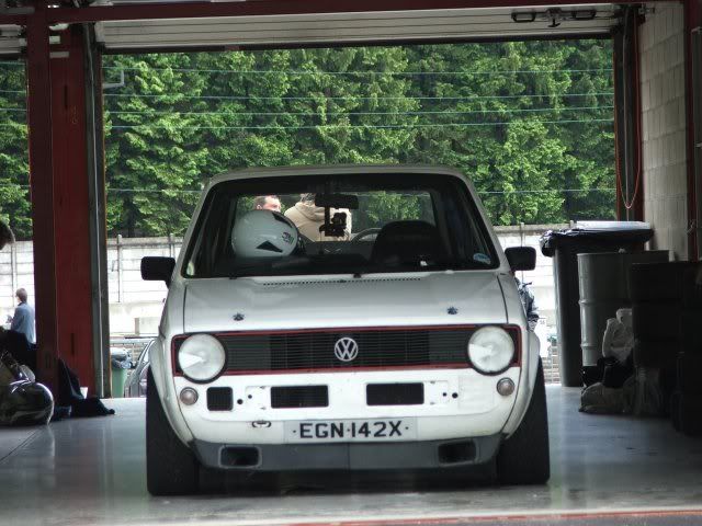

Here's the spec of mine.....
2L 16v ‘abf’ Engine with flowed head and KR cams, modified air intake, 4 branch manifold with 2.5” Jetex Rally system, Baffled sump, Lightened Flywheel, Lukazade home mahe catch tank with Piper X filter
Helix Clutch with HD pressure plate and sprung organic friction disc.
Close ratio box - 3.89 FD and ATB LSD diff
with rose jointed linkage, quickshift and extended lever
Quaiffe quickrack 2.9 turns
Revised geometry - Ball joint spacers and rose jointed trackrods
To allow addition lowering without affecting factory rollcentres
Avo Coilover adjustable suspension with a selection of spring rates and solid adjustable eccentric topmounts(running 400lbs rear and 350 lbs front)
Converted to studs front and rear for easier wheel changing.
Eibach Anti Roll bars
Front lower and rear upper Strut braces and polybushed throughout.
VR6/G60 front brakes (280’s) with race pads and braided hoses
6 point Rollcentre cage with Harness bar
Luke Harnesses (6 point driver, 4 point passenger)
Polycarb windows and fully stripped interior, inc sound deadening and sunroof removed.
Cobra Monaco seats, (drivers side adjustable)
OMP Deep dish Corsica Wheel with Sparco 50mm spacer( now OMP racing flat bottom wheel)
2 sets of wheels with slicks and Toyo 888’s and a spare set of slicks (running Toyo T1 S as they flex a bit and soften the ride)
At Spa :smiley:

Now then i know your car, a mate of mine lives and works at the ring as i remember your car runs about 81/2 mins round there dosent it?The spec is indeed a good one for the trackday scene and quite possibly a race winner from what i can see.

Yep the car did the Ring with Ian (guy who built the car) doing 8.51  http://www.youtube.com/watch?v=COdjeiww0I0
he says with a driver who knows the track you can get 8.10-20 out of it. I bought the car from him earlier this year and after being accepted to buy it (he turned a few people down as he wanted it to get well used and lokked after) so you might have seen it on Pistonheads.
The injection system is from the Mk2 16v (K-jet) and Storm Developements www.stormdevelopments.co.uk put the car on the rollers and found the fueling a little lean at the top (common for k-jey 16v) so set it up for 0.85 through the whole range. The inlet and zorst are polished and ported (details in a pm tomorrow of the supplier) but standard fit Mk2 16v. I can't recomend Storm enough...they look after my Mk3 16v Amd as well and do great work and offer so much help. I've spent time in thier workshop as they let me use some space when needed as I've passed on lots of work to them, just because they are so good.
Car does constant 0-60 5.2 and will go on to 145(datalogged) and is set for reliability as much as power. I did get 194bhp and 137ft/lbs but opted for the fueling and 180bhp 150ft/lbs as it was more driveable and the power is accesible earlier on.
