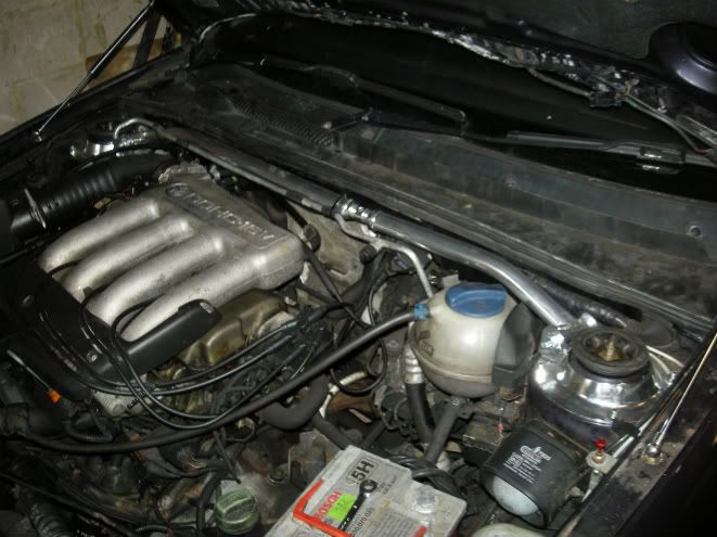

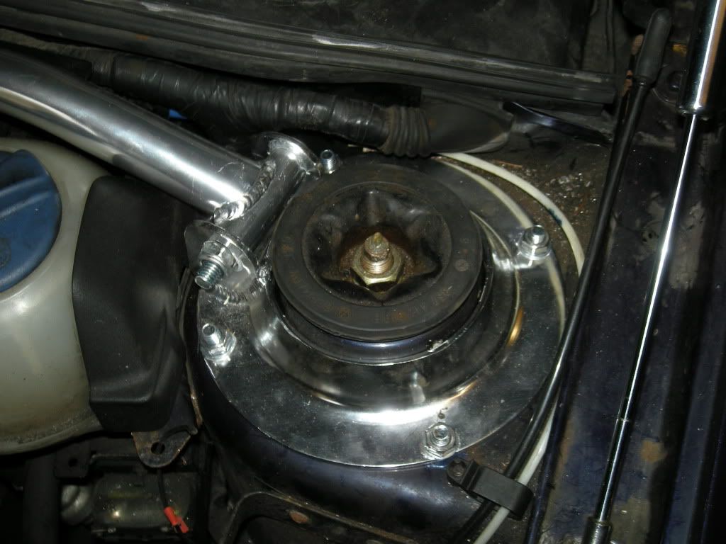

Offline Len
  • Posts: 16,292
Re: Len405 - mk3 16v
« Reply #107 on: 08 February 2010, 20:20 »
Well not started those sills yet as I may do a bit of work on the passat!
So here are those promised pics of strut brace.
www.sas.org.uk

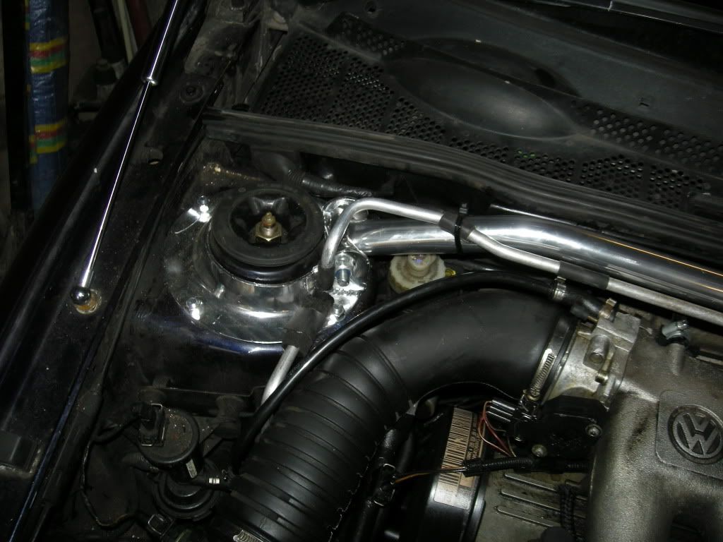

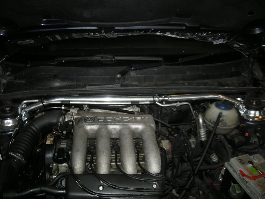

Offline Len
  • Posts: 16,292
« Reply #108 on: 08 February 2010, 20:26 »
A few more.

Offline Len
  • Posts: 16,292
« Reply #109 on: 10 February 2010, 14:02 »
Used a bit of soft tape ( think it was pipe repair tape) around that top ally pipe at the 2 closest places and a cable tie.
