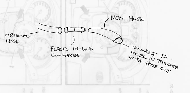

I used parts that I had (well my neighbour had) I think that were removed from a scrap Volvo! The plastic inline connector you can buy from Halfords etc.
Hopefully the rough diagram will give an idea as to how I did it (sorry its a bit rough, had a few beers :drool:)

Offline Mantamad
  • Posts: 198
Re: luggage compartment/ alram
« Reply #7 on: 24 December 2006, 21:41 »
Forgot to add, the new hose was a very tight fit over the connector on the motor - I opened it out a bit with a philips screwdriver so it would push on easier. I then fitted some rubber fuel hose over it and then fixed it in position with a hose clip of suitable diameter for the fuel hose.

Offline nadlad
  • Posts: 1,434
  • Building Surveyor MRICS
« Reply #8 on: 24 December 2006, 23:33 »
cheers ave wrapped it with duct tape checked not a single leak even when the boot lid is open and the pipe is vertuically down cheers though!
