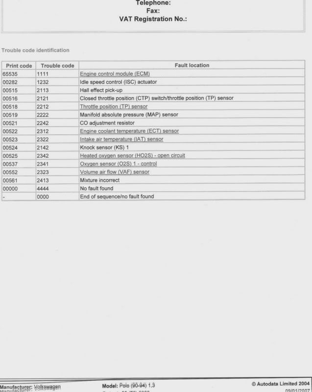

Ok, given this a go this evening and it looks like all that works with this set up is the flashing led's. Anyone know how to interpret what the various flashes mean?
It looks like it is trying to tell me loads but I don't know what the various red and green led flashes correspond to.

Well I have tried it again a number of times and the results are consistent:-
4 short flashes
11 long flashes
4 short flashes
I know the last 4 short flashes means end of test but can't make head nor tail of the rest of them.
I'm hoping, at the very least, that I have cleared and or reset something so I'll take it for a drive shortly.

I've got fault codes if you want them  :wink:
