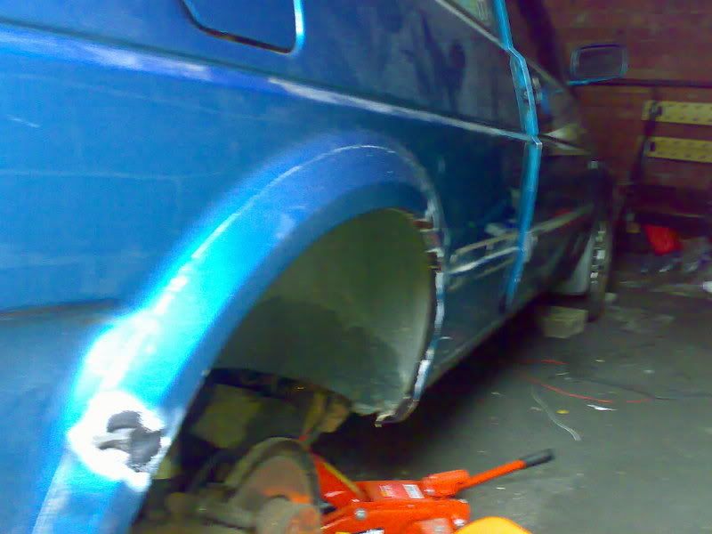

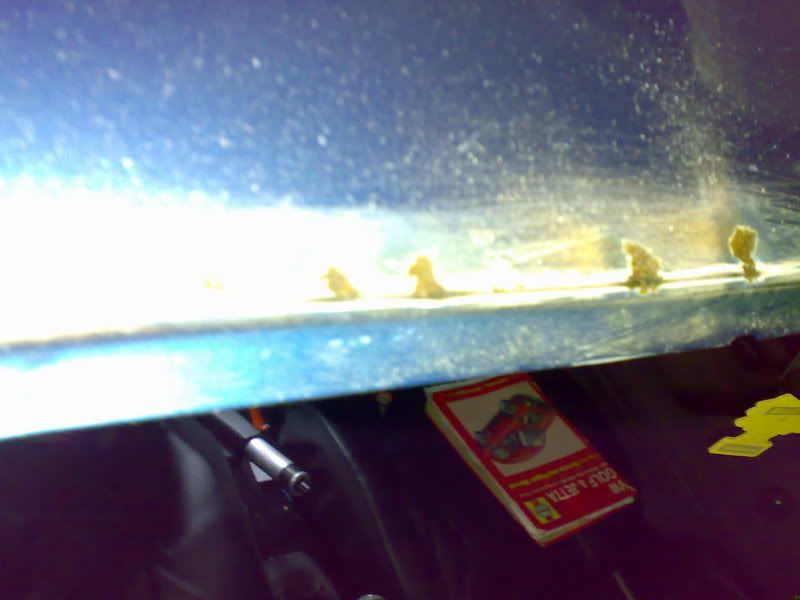

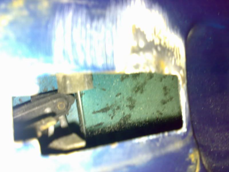

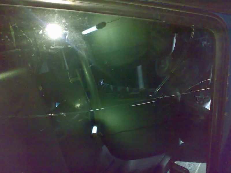

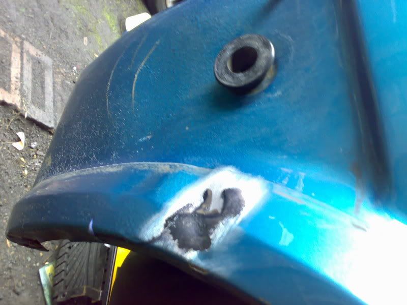

Well it begins!
Rusty dinted rear arch,
Back left Corner,
Drivers door handle,
Broken windscreen :(
Screen seal,
Now rust treated and I've started beating, filling, masking and priming :)

So what did you use to treat the rust?
Offline monzablue16v
  • Posts: 2,537
Re: Best way to remove a bit of tinworm and repaint. ????
« Reply #19 on: 29 October 2006, 13:56 »
It's belgian can't recall the name I'll get it later on, it goes on like copydex white liquid, then turns any rust blue then purple then black.  I also have Waxoyl to spray on the behind of the panels that have rusted.
