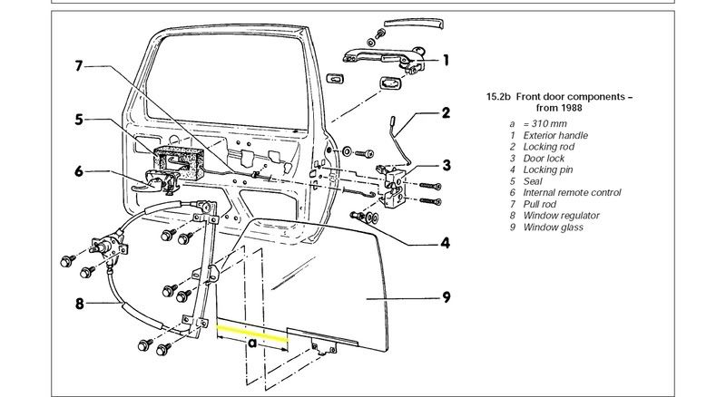

Re: my window whistles
« Reply #5 on: 16 November 2006, 14:58 »
here's a pic !!
measure the distance from the edge of the glass to the bracket that holds the glass ( shown in yellow).
mine was out by 10mm !!

Offline Gambit
  • Posts: 4,354
« Reply #6 on: 16 November 2006, 15:19 »
perfect explanation!!

Offline 8vRicey
  • Posts: 485
  • Silver Mettalic 8v GTI
« Reply #8 on: 17 November 2006, 20:41 »
Excellent, i shall try to do this on mine when i have a bit of time. Do you have to take everything out of the door to do this, or can it be done by just removing the plastic membrane?
Cheers :)
It's a glass out job.
Remove door panel, undo nuts that hold glass in, remove rubber from around window aperture, and then remove glass from door.
The bracket that the glass sits in is very tight on the glass, so be carefull when taking it off.
I used a bit of Fairy Liquid on the glass when putting it back on.
Good luck!
