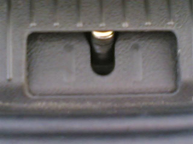

Ok i have taken some pictures of the problem (if there is even a problem) with the door pin/lock...  Can someone tell me how to upload them into a msg because i dont see a attach option? And after they have could someone tell me if there door pin/lock should be like this on the boot.
Thanks
Blingster + GF

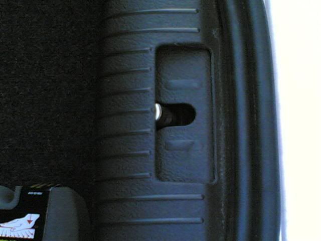

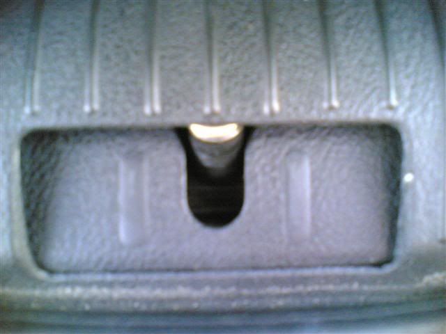

Hey plps, I have worked out how to upload pictures now so here goes! This is what the boot catch looks like...
Let us know your thoughts, We have checked fuses inside drivers door and changing these doesnt seem to make a difference!
Cheers
Blingster

Agree with fuse suggestion.. and that pic of the boot locking pin is normal.

You are looking in the wrong place! The micro switch it mounted in the rear door (hatch) latch mechanisim not on the body mounted latch you have photod. You can access the switch by removing the door card trim from the rear hatch, its a small switch integrated into the latch. IIRC its got 3 wires, centre 1 is an earth connection, the others are - 1 for boot light and 1 for door open sensor.
