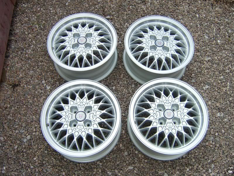

I have just ordered some nice BBS RA's, and would like some nice new shiny wheel bolts to go with them.
What size and taper are they??  :undecided:

M12x1.5
The bolt seating depends on the wheels, if they are std VW then they are likly to be ball/cone, if aftermarket they'll most likely be tapered.
Unless you know for sure, remove one of the bolts and stuff a load of bluetak into the bolt hole, pull it out and check the shape :)
And here are the part numbers of the correct McGard locking wheel nuts, pretty much the best on the market:
28028SU - cone/ball
27179SU - tapered
Edit: Roughly 26mm long for alloys, with a 17mm hex head

yes and no, BMW bolts happen to be the same thread as MK2 bolts, but with a tapered rather than a ball seating.
If you have aftermarket alloys with a tapered seat they're perfect, but if you have a set of std VW alloys with a ball seating they're no good.
On the same note, if you get a set of aftermarket alloys with a tapered seat, nick a set of wheel bolts off a BMW to fit them :)

I think i should be sorted, ordered some new McGard locking nuts and some new wheel bolts (both radius seat). Hopefully they will turn up at the same time as my RA's !!
