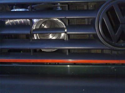

I decided to make a direct feed for my airbox. I got some pipe from Halfords for £7.
I cut a bit out of the grill that the pipe needed to sit behind and re-stuck the grill part so it was flat instead of facing downwards. My idea for this was the air could flow straight into the pipe rather that coming up from under the grill.I could have left the bit of the grill out but thought it looked chav.
I then got the hose and using 2 cable ties tied it to the alternator housing...as far away from the alternator blades as i could!! Using a dab of no nails on the holes i had to make for the cable ties to go through as dont want any air escaping! Then put the end of the hose about 1" from the intake on the airbox.

Dont want a boy racer iduction noise. Just want cold air to get into the airbox fast. If left standard the air comes from beneath the grill and into the engine to where the 2" dia' square intake has to pull in air. If a feed from the grill is directly fed to it the mid range responce is a lot better as there is a constant force of air going in. I put a hairdryer to the grill and felt behind it, not a huge amont of air going in...put it to my air intake and feels like you have your hand over the front of the hairdryer which =  :smiley:.

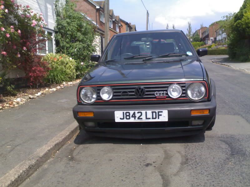

Horrible??  :cry:
This is a pic a few feet away....doesnt look to bad does it?
Cant really see it....but its there taking in air like Ben Johnson on a sprint!!
