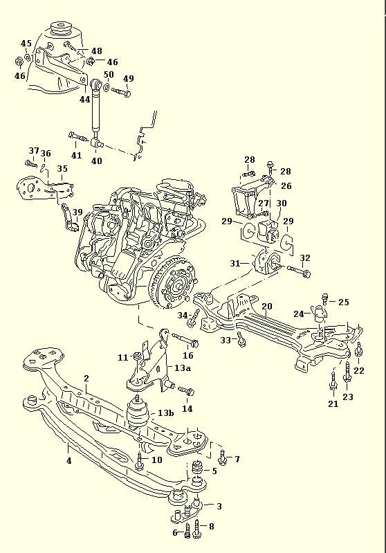

That sounds too easy!
Its part number 20 that effed, are you talking about the fron bit (number 2)?
cheers
Offline ...joe
  • Forum Supporter
  • Posts: 6,294
Re: Oh No!! Subframe required!
« Reply #5 on: 27 May 2006, 15:42 »
rart 20 is the subframe yeah, but to be fair i thought you were talking about your cross member from your description. the subframe is alot more work but just a matter of supporting the engine, then undoing evrything that ic connected to the subframe. ie steering rack, engine mounts etc

just to be clear you defo arnt talking about the bit at the front under the radiator?  If not then its a little harder as you have to support the engine & the gearbox, plus swap the anti roll bar etc.  Not only that you have the risk that the subframe captive nuts will shear off :cry:

defo not the front one under rad. Had it up on the ramp.
what happens if the nuts sheer off?? Can't get bolt out? (angle grinder??) then new bolts?

the steering rack bolts are sort of captive and the nuts are the way of tightening/loosening, not fun if they are knackered!! i had a few blue word when i replaced mine!
