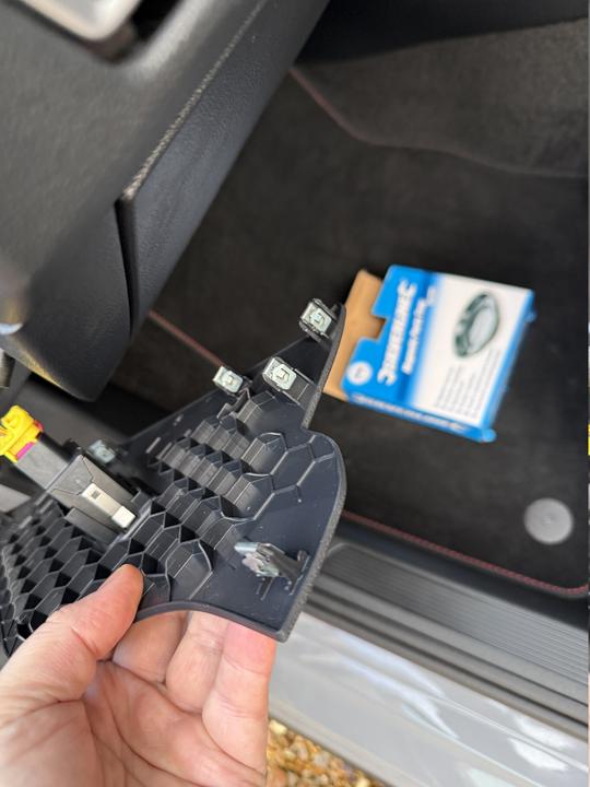

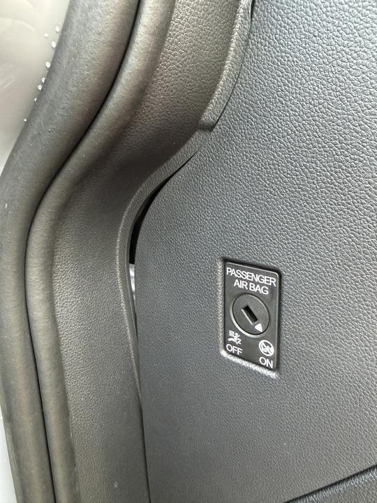

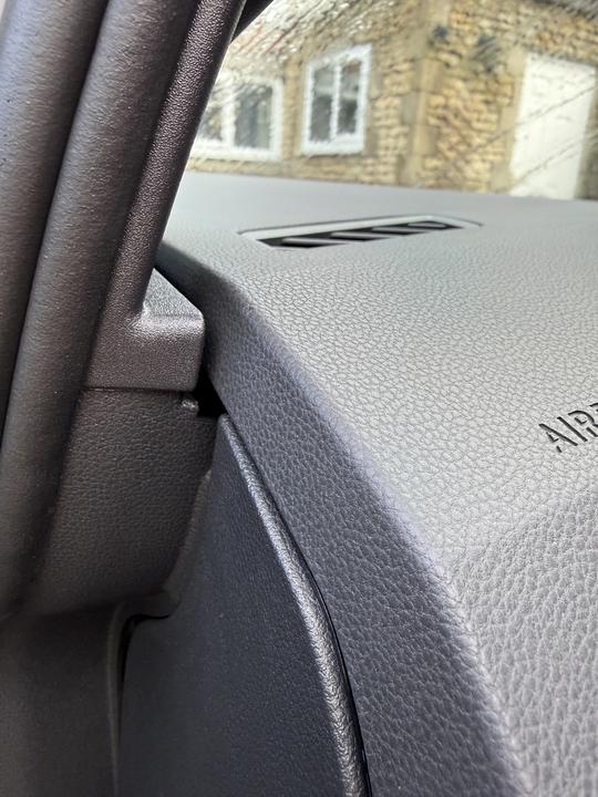

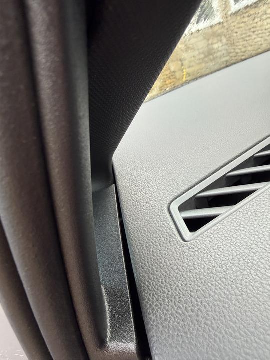

My car, 2025 GTi has just had its first service. Around 3 weeks ago I noticed a slight rattle coming from the left side of the glove box, on exam I could see that  bar that controls the glovebox lowering was broken or had just fallen out. I hardly use the glove box and hadnt noticed any issue with it that could/would have caused this. Whilst looking around I also noticed that the panel at the end of the dashboard (with the passenger airbag on/off switch in in) doesnt fit properly, leaving a small gap (see pics)

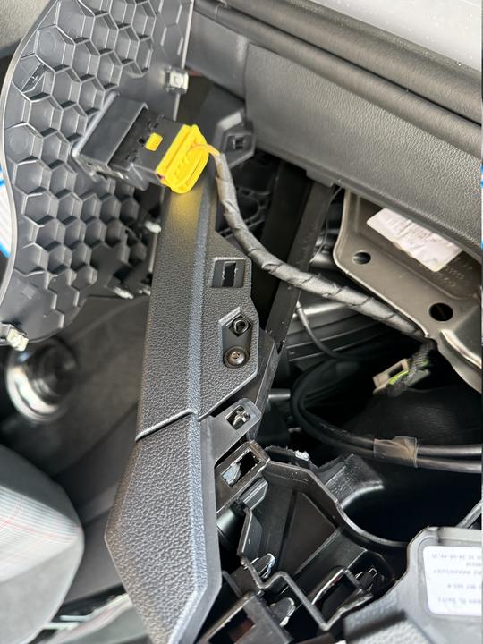

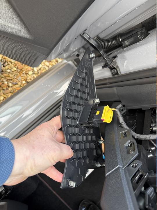

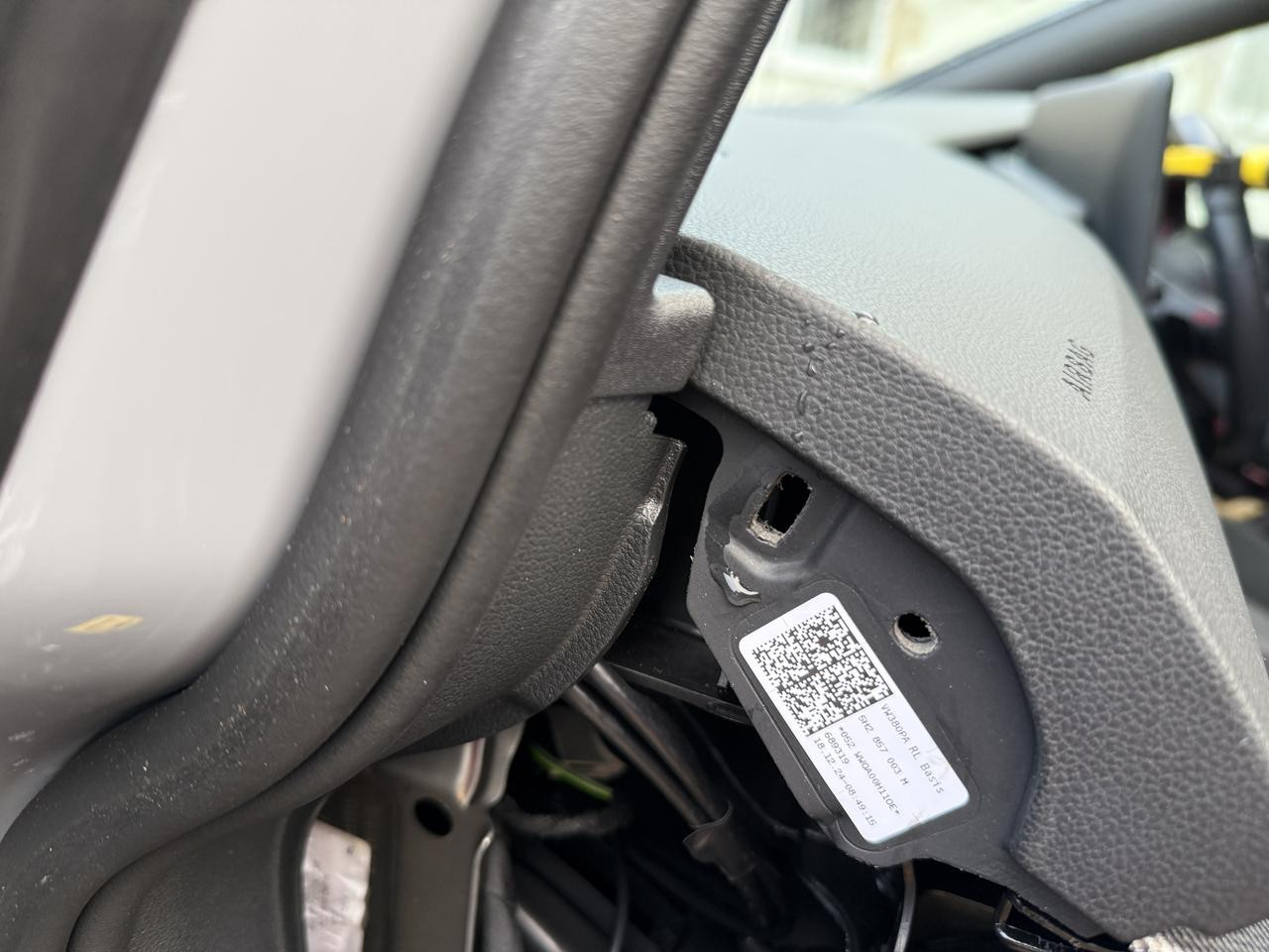

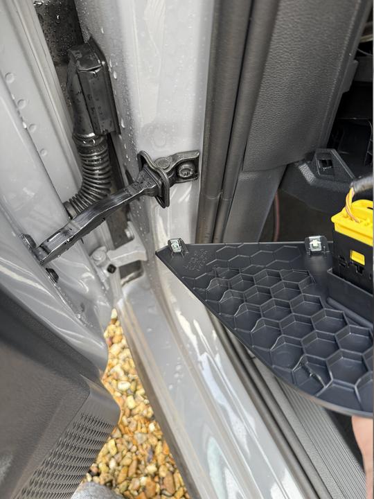

So I have today, popped that panel off and have confirmed its NOT damaged,all 6 clips are presnt and undamaged, so why doesnt it fit. The more I looked at it the more I now think its the small slim panel next to the gap which is slightly misaligned. The panel doesnt have any clips in that area to secure it to anything and the metal bracket underneath doesnt have anything on it to stop that panel from pushing in to make the gap.
From my pictures can any of you tell if anything lokks missing or broken? Or could anyone have a look at their own car to see what it looks like in comparison?

That narrow curved panel between the end panel with the airbag switch and the rubber door seal is probably not fixed in properly, it has a fixing at the bottom that fits over and into the trim piece below it, I’d bet that bit is not inserted properly, and is therefor distorting the shape, with the dash end panel removed you can pull the narrow trim piece out, take a look and see if it can be realigned.
Thank you, I’ll take a look at that  :smiley:
8.5 GTi Moonstone Grey, Harmon Kardon, DCC, Queenstown Wheels.
Offline K9Pyro
  • Posts: 13
Re: End of dashboard panel, issue?
« Reply #6 on: 06 February 2026, 11:17 »
I've looked this morning, the panel isnt broken, but it seems so flimsy and is only clipped in at one end, the rest of the fitment seems to rely on it fitting in behind the door seal and 'just fitting' into the plastic above, nothing connects it to the air bag panel to keep those together and looking good. I've improved the look but will probably resort to some duck tape to try and improve it further.
