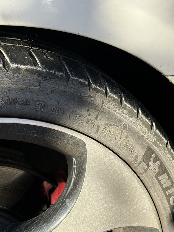

Also, how old are the tyres? I had P-zeros on the back of my GTi when I bought it, they still had 5-6mm across them but were 4 years old. I didnt want to replace them but the rear end felt "hard" and very droney. I ended up caving and putting PS5's on the rear and it was the best decision I made, the tyre fitter told me my P-Zeros had gone almost solid rubber and basically began to break apart when they took them off the rims, shows fracture signs on the inside and they even showed me hairline cracks along the shoulder edges. Soon as I left the tyre shop I instantly felt the difference in comfort and on the motorway, the slight drone disapeared which I first thought might have been a wheel bearing begining to fail. So yeah, if your tyres are 4+ years old, I would recommend have them at least inspected.
On the tyre sidewall, look for a string that starts with “DOT” followed by letters and numbers.
Example: DOT X0YZ 1219
The last four digits tell you the week and year the tyre was manufactured.
First two digits → week of the year (01–52)
Last two digits → year
Example: 1219 means the tyre was made in week 12 of 2019.
So in short: PCV seems fine, keep an eye on the valve cover gasket, and check tyre pressures & tyres. That should cover most of what you’re feeling.

Tyres are pilot sport 5
Looks like 2023. Same on all 4. I’m going to check pressure on them later

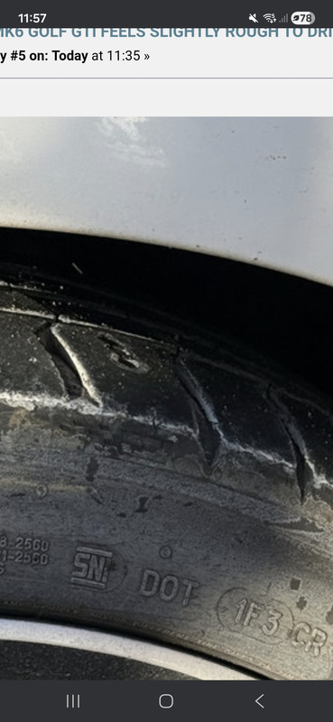

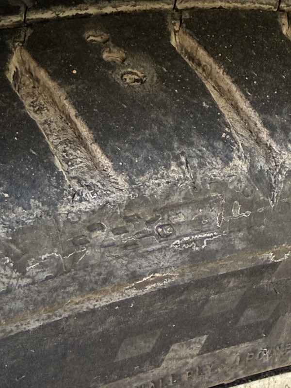

Is that a couple of holes in the tyre?
Offline VW91
  • Posts: 19
Re: MK6 GOLF GTI FEELS SLIGHTLY ROUGH TO DRIVE
« Reply #7 on: 05 January 2026, 12:24 »
Wear indicator I think?  Same on all 4 tyres.  Think the outer side more worn than inner. So maybe needs a 4 wheel alignment aswell
They look like tyre plugs, meaning the tyre has has 3 puntures  :shocked:
