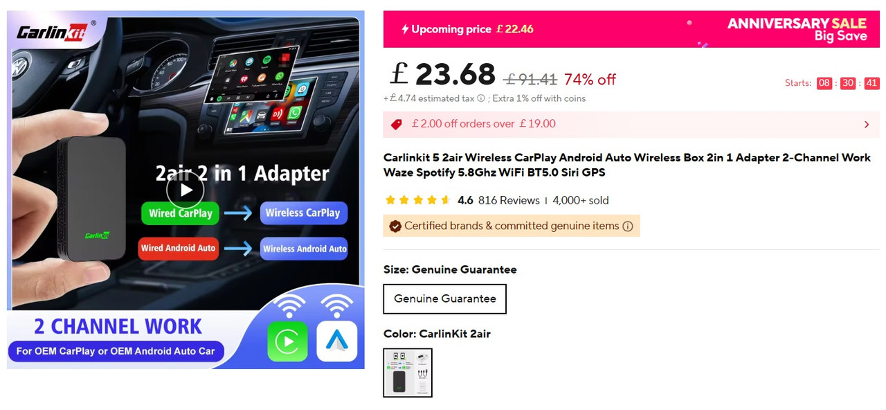

« Reply #1 on: 15 March 2025, 14:21 »

Re: Wireless Android Auto / Carplay dongle
« Reply #2 on: 15 March 2025, 17:42 »
Thanks for the swift reply. So basically, these adaptors will work in  a Mk7 Golf 2016?
Any reason why you opted for the one you chose?
Thanks for your time.
