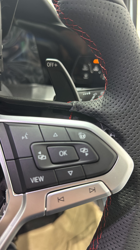

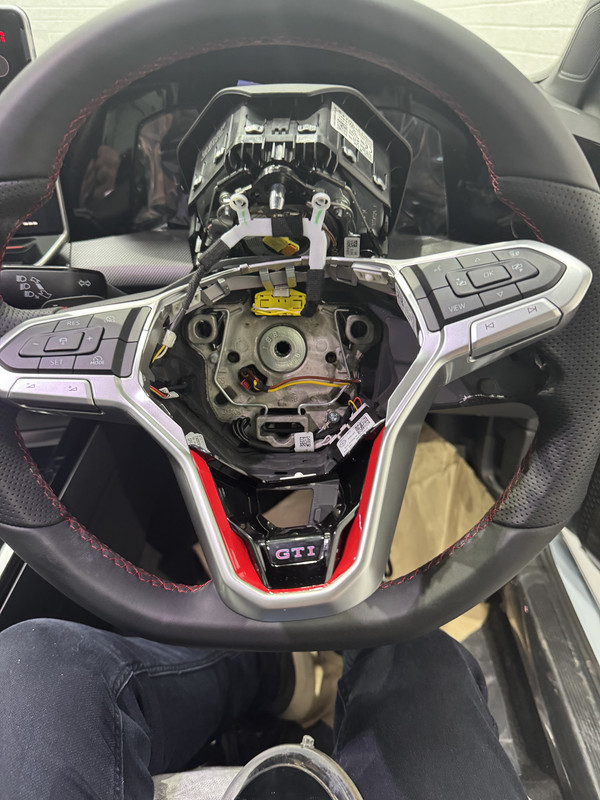

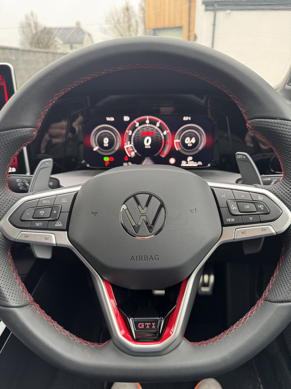

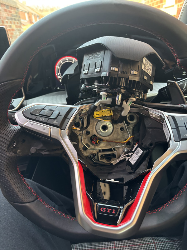

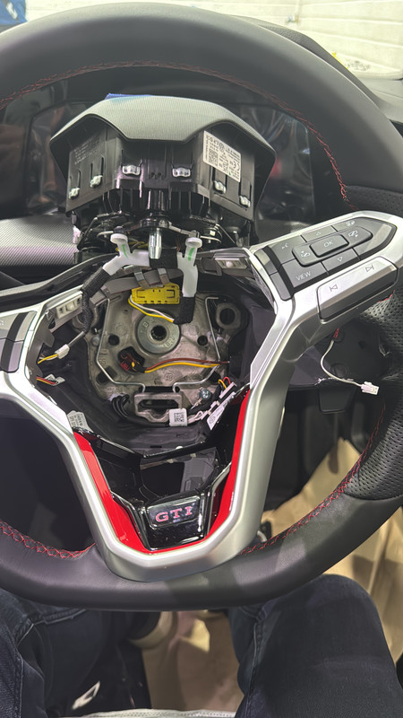

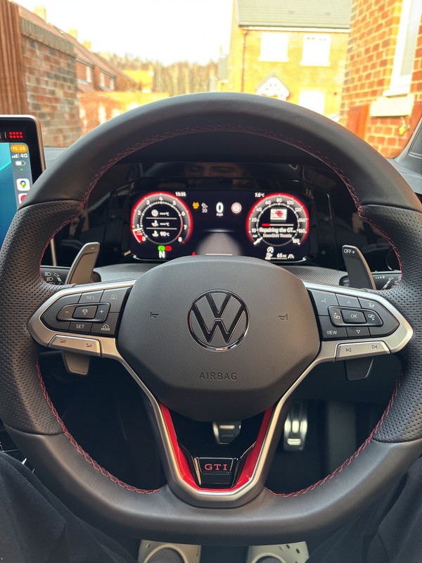

Yep I’ve done this a few times now! Twice on my MK8, as I installed them 3 years ago and then I removed them again recently as I had that car traded in for a new one. And as Exonian mentioned, I posted a photo of them fitted to my new 8.5 CS. I also fitted them to a friend’s new CS a few weeks ago.
You do not need to disconnect the battery. In fact I didn’t disconnect anything other than the paddles themselves. I managed to do it without disconnecting the airbag too. I just popped it out and rested it on top of the steering wheel, in front of the MFD. You still have enough wiggle room to do the job without unplugging the airbag.
Trickiest part was removing the trim / buttons part. It takes some gentle persuasion. Take your time with it and it’s not too bad.
Here’s a few pics I took, some from my friend’s car, some my own.

Removing the airbag is quite easy. There are 3 spring loaded clips. I’d suggest unclipping the upper plastic cowling on steering column, it unclips easily. Lift that up and extend out and drop the steering wheel as far as it goes. Just to give you as much clear access to the back of the wheel as possible. Then get a mirror (I borrowed my wife’s makeup mirror!) to help you see what you’re doing. And a small flat blade screwdriver. Take your time, unclip each clip and turn the wheel to get to the next one.
And do not turn on the ignition while you are doing it. Just in case!
