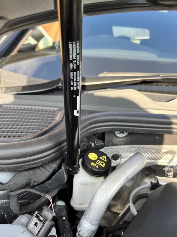

Fitted a Racingline bonnet strut today, very simple and very effective.
Just need a 10mm deep socket or a 10mm spanner, pliers, some lithium grease and 10mins spare.
I greased the ball nut and thread to avoid seizing plus the ball ends at the top and bottom. Pliers needed to release and rotate the coolant hose 45deg to avoid that rubbing on the strut.

so these don't come standard ? any reason why lol ?

I can’t see it’s cost cutting, the parts for a bonnet stay are probably the same. Maybe it’s an NCAP crash thing, it’s a bar directly in front of the driver.
