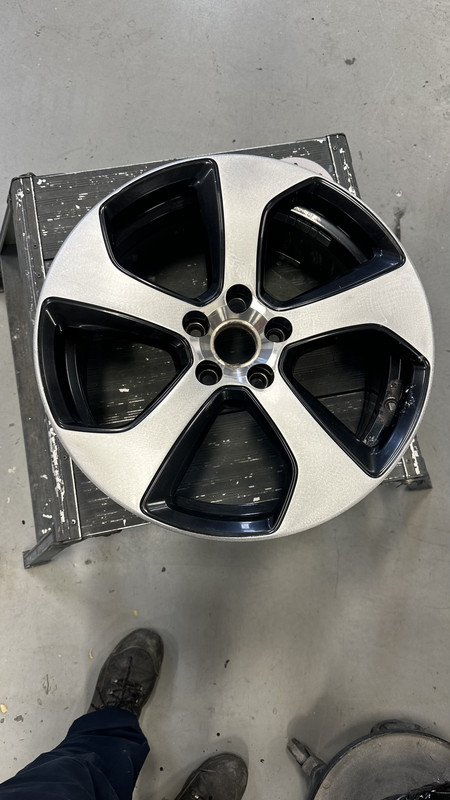

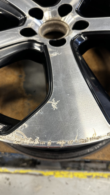

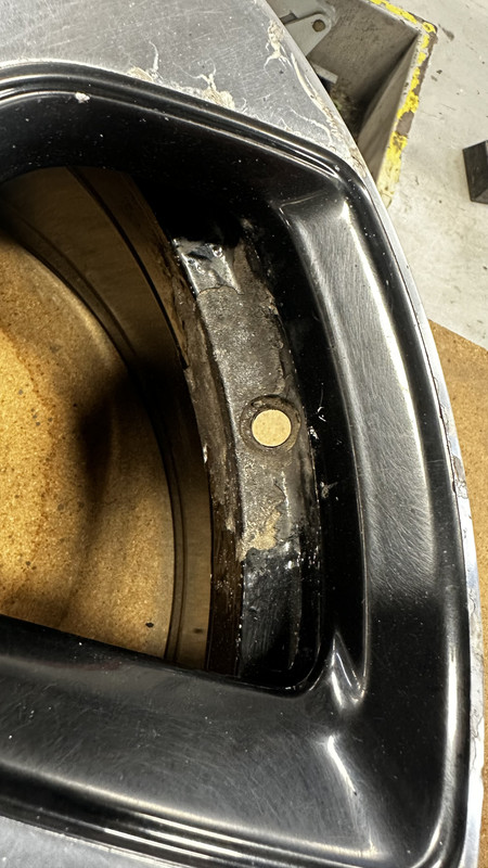

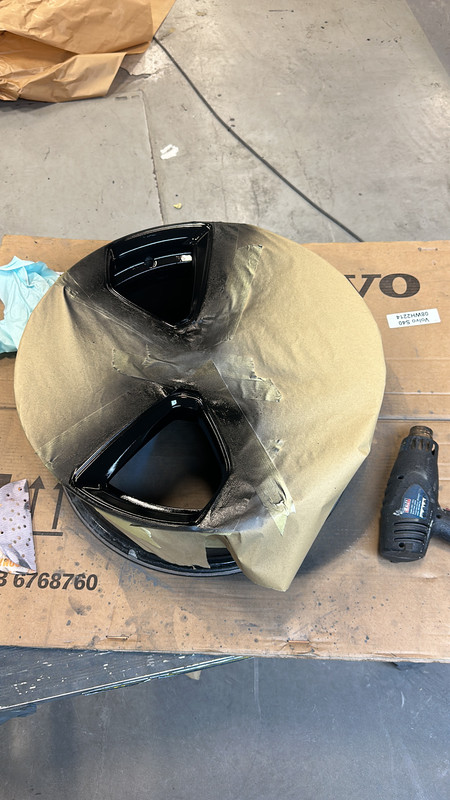

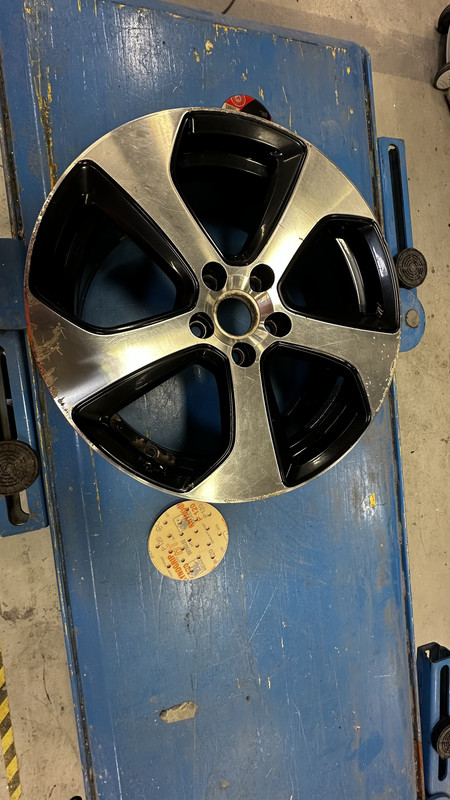

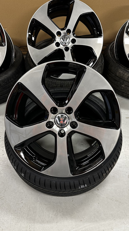

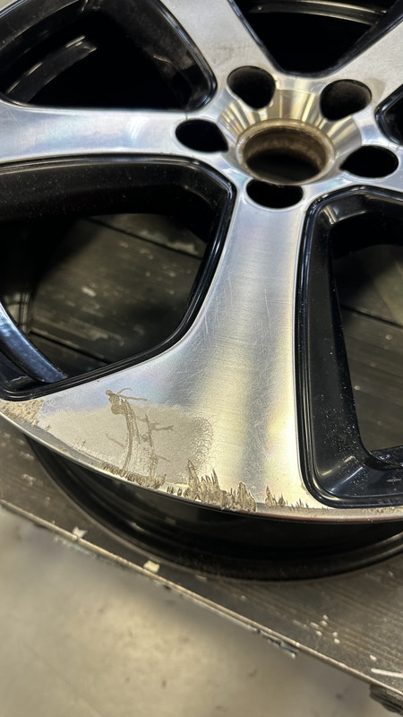

Looking to get all my standard 18 Austin alloys refurbished as they have been curbed one too many times. What is my best way of going about this and is it and how much should it cost?
I had the same issue and was thinking of getting them refubed. I was quoted 500€ here in Dublin and was told that the wheels would look slightly different due to the material removal. Since I'm working in a workshop and have acess to all sorts of tools I decided to bit the bullet and try to repair it myself. (never done it before) After a few DIY videos and a lot of work, they came out better than I expected. I'm into detailing so I've done a few sanding jobs before so not completely inexperienced on that.
I've sanded them all from 180 up to 5000 and lacquered after that.
Firts time posting so I'll try to upload a few images of the process.

« Reply #18 on: 03 October 2024, 14:19 »
Here's the link of the images. Not sure if it'll work.
Just took some pictures of the stages I went through.
https://imgur.com/a/igZZuun
@MattNasc; They look great in the ‘after’ pictures. A job very well done! :cool:
