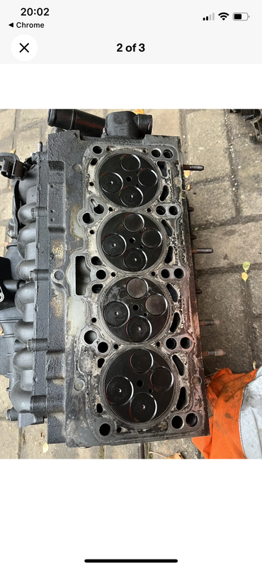

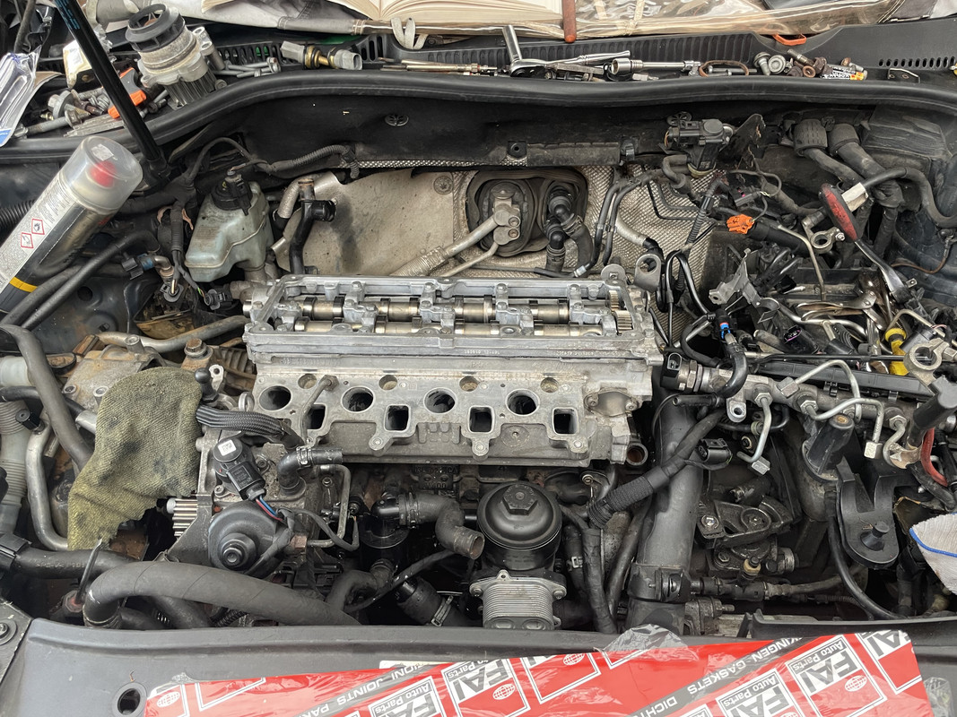

Thanks Nino and Snoopy for the reply, I just spent the week stripping it down completely and you are absolutely spot on. The head gasket was completely blocked with a sealant, possibly K-seal…
I had the head skimmed, pressure tested and the valves and seals reseated, I have replaced every gasket and literally scraped 90% of the remaining sealant residue from the bottom of the block then rebuilt it and filled with deionised water and antifreeze.
Changed oil, oil filter, air filter, new glow plugs, new injector seals, new copper injector washers, cleaned oil cooler, flushed all hoses, flushed the new radiator, cleaned out the thermostat housing, removed and cleaned the heater matrix with wet and dry vacuum, I have replaced everything I possibly could.
It’s now all back together with the new down pipe, I deleted the EGR valve and blanked everything off, the amount of carbon buildup in the inlet was ridiculous, I had to scrape it out and used a lot of carb cleaner to get it clean. It was a mission but car is back together and temperature is finally as it should be. Thank you for your advice, much appreciated!
