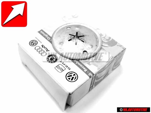

As said above back box and behind the down pipe, tap them and if they are loose you will know (obviously let car cool down completely at it says hot by the CAT). Held on with Insta-Rust spider clips. If under Warranty tell the dealer to cover your back if you don't find anything.
