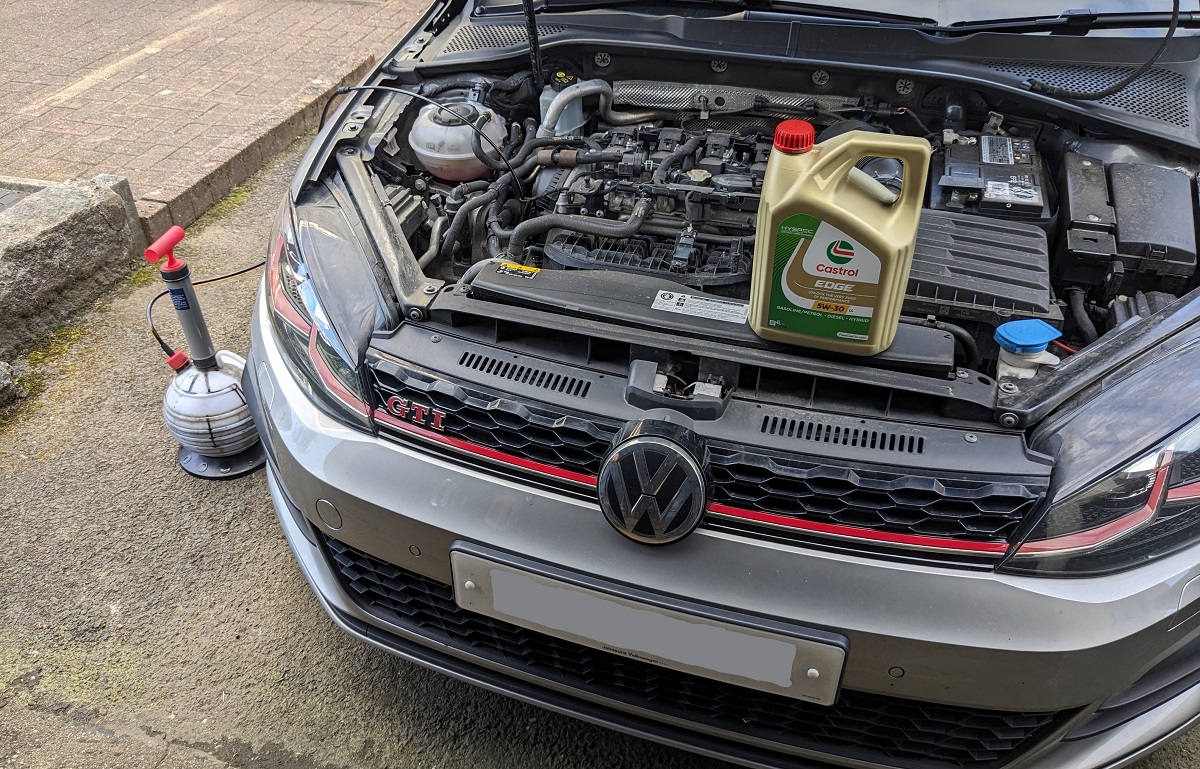

so I went with 504 spec Castrol Edge. 4l can = £35.
4l of Castrol Edge 508 spec was £50. Prices from Halfords.

Please tell me you sucked out more than 4 litres of oil. Capacity is 5.7 if memory serves me right

« Reply #8 on: 23 April 2024, 20:11 »
yeah, i sucked it all out.
I had 2x 4l tubs of the new stuff.

« Reply #9 on: 23 April 2024, 21:53 »
Lovely ! You had me worried there for a second  :laugh: :grin:
