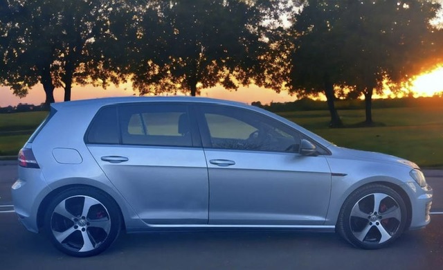

Looking through the pictures in the sellers ad., it looks as if it’s had some new paintwork on the driver’s side - the driver’s door is a noticeably dark shade than the rear door (see picture below). Also, the 6 speed DSG should be serviced every 40k miles, so with the car having done 98k miles, the DSG should’ve had two services by now which would be a bit of a red flag for me.

Look at the vcheck report way too many MOT red & amber warnings...not been looked after...also the front & rear bumpers & the drivers door are different shade of silver...I recon its been crashed & not declared/claimed on insurance & privately fixed up.

Does anyone else think the wheels don't look centred in the arches? Mainly the passenger side.
