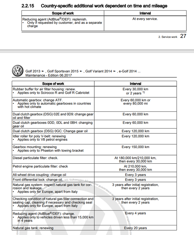

Offline golfdave
  • Posts: 280
Re: First OBD11 Scan Results
« Reply #28 on: 19 January 2024, 14:39 »
My servicing dealer steadfastly maintains that servicing and oils change for this component does not appear on any VW U.K. servicing job list.
I have to confess, the way I drive nowadays it’s less frequently  that the feature will kick in and if that is the case maybe my oil and filter will be relatively “clean” anyway even after 5 years??
Find a different servicing dealer, as its well known by now where in the VW service logs/tables the schedule is "hidden"...
Screengrab from the ERWIN service books....
« Last Edit: 19 January 2024, 14:41 by golfdave »
Offline P6GTD
  • Posts: 675
« Reply #29 on: 31 January 2024, 17:10 »
Thanks for that Golfdave.
Last year I asked my dealer about changing front diff oil and they insisted it was sealed for life. And a request about this seemed utterly novel to them.
Last week, armed with your evidence I spoke to them again about my forthcoming service.
They have come back to say that after referring to their senior tech who has done some investigation, they agree the oil should be changed and are going to do this. Should be done every 3 years!
The cost of £127 is not part of the “All In” deal though.
It’s all very strange.
I will just be glad to get it done.
