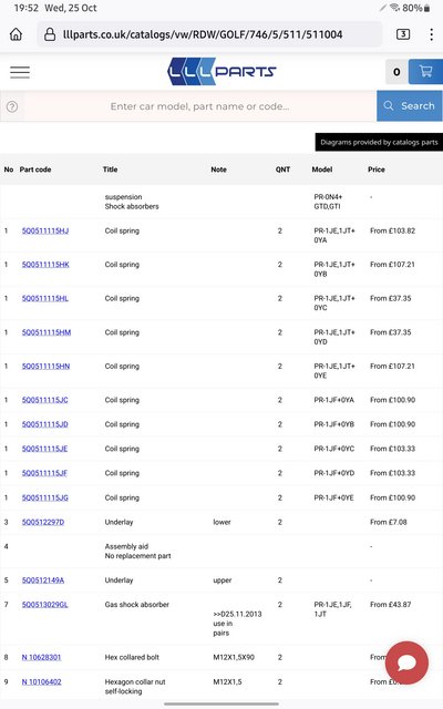

Thanks for the info so far. Yes I will be replacing both rear springs.
Surprisingly Vw quote the same part number for all mk7 gti’s.
2014 gti pp dsg
Offline madstaff
  • Posts: 709
Re: What standard replacement Rear Springs do I go for ?
« Reply #6 on: 25 October 2023, 19:57 »
I can guarantee you there's more than one spring for a MK7 GTI depending on spec.
They may have all the same numerical part number but the letter/s after denote a different spec.

« Reply #8 on: 25 October 2023, 21:23 »
I can't see how that one same spring can fit all those different models when a CS40 spring rate is 10% stiffer than a GTI ???
Physically fit - yes, but actually be the correct spring rates - IMO no.

« Reply #9 on: 25 October 2023, 21:53 »
I must admit I was only looking at the standard and performance pack. Not the cs40.
I would expect that to be different.
