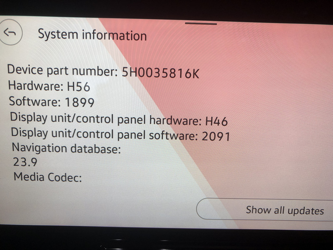

Should be a fairly obvious thing for you to answer for me....I'm talking about travel assist/front assist bongs btw... the hardware version can be seen on this screen:
