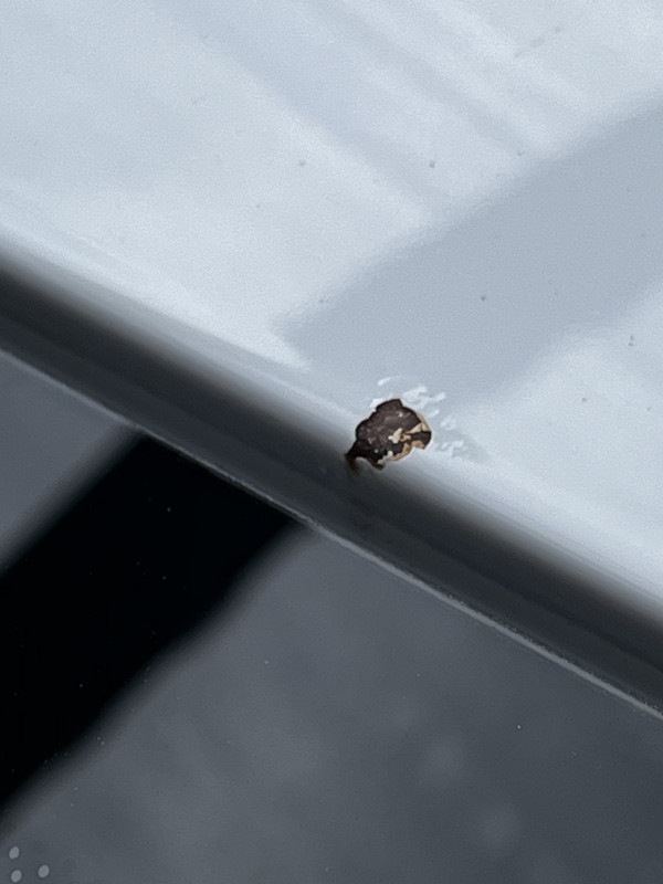

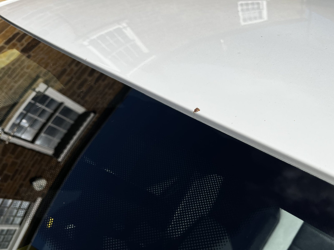

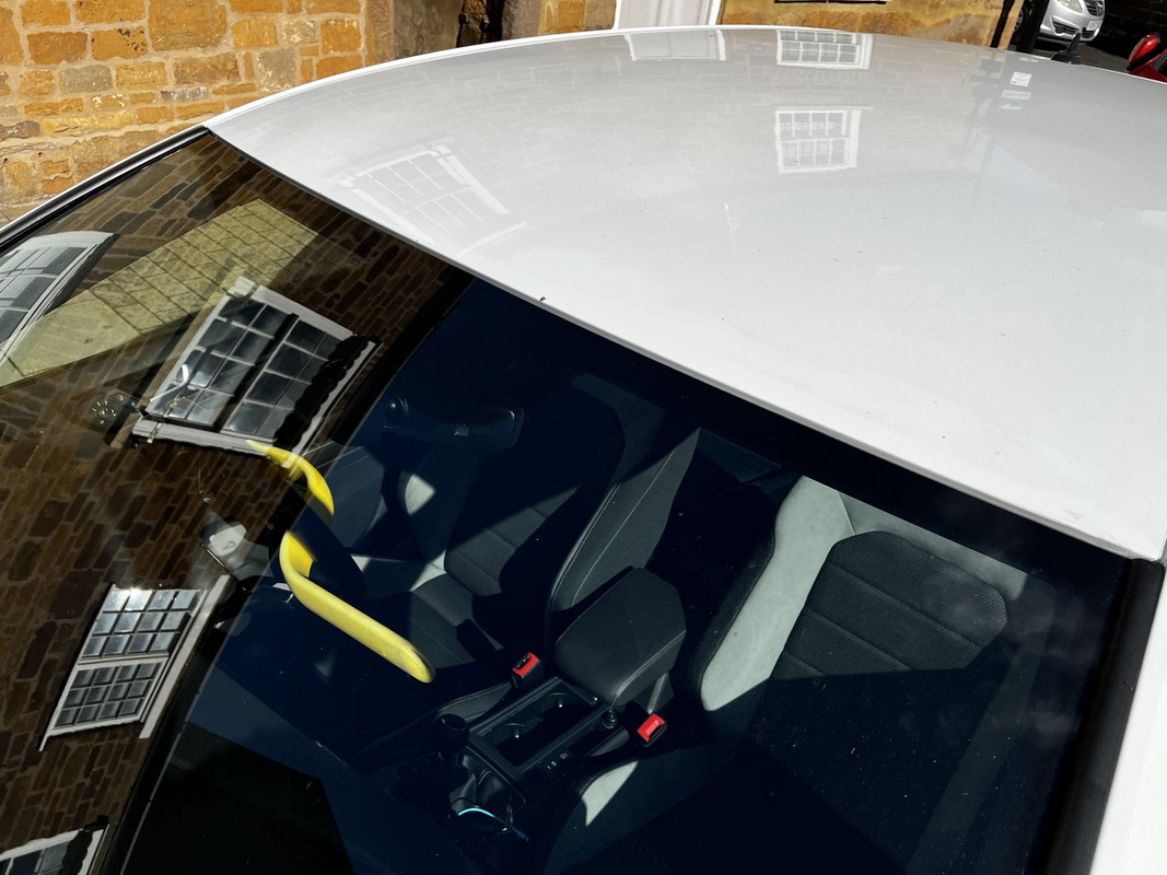

I have a few stone chips on the front lip of the roof just above the windscreen. The worst is the one I've pictured, around 5mm. There are about 4 others about 1-2mm. Just wondering how I should deal with this and get this fixed?

The stone chip in your picture looks quite old judging by the pitting of the exposed metal. In the last picture, you can see corrosion has also spread beyond the area where the paint has been removed as there’s blistering under the surrounding paint.
If it was a new stone chip it would be easy to do a DIY repair (paint touch up pen or a kit like those sold by Chipex or Dr Colourchip), especially as Pure White is an easy colour to match and any slight differences if finish wouldn’t really be noticeable. However, the corrosion has spread under the surrounding paintwork, so the repair needs to extend beyond the area of exposed metal - I’d therefore probably get it SMART repaired. There are quite a few independent SMART repairers so it’s not necessary to just use the nearest Chips Away franchise.
