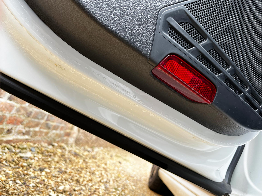

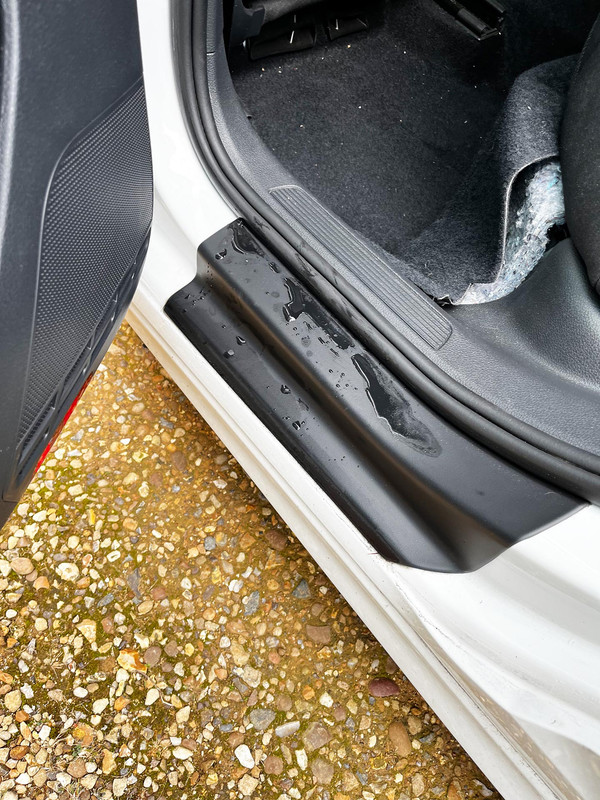

I've had the previous water on rear sill going between the rubber and ultimately ruining my carpet and underlay (of which I'm replacing this coming weekend!). I sealed the speakers but the carpet and underlay is past repair.
However, is it still normal to get water on the rear sills. There's no water going between the rubber seal and I actually think having the plastic sill protectors makes the situation a little worse as the depth of those means they're very close to the underside of the door so if water comes around the door frame aperture if must then get a little trapped.
What I don't want to do is replace the carpet and underlay only to find out the water is still getting in.

The question still remains, is it normal to have water on the door sill i.e. on the metal but not the plastic part?
I've done the speakers and still get water pooling on the exterior part of the sill.

« Reply #9 on: 18 September 2023, 07:40 »
Sometimes see that on mine.
I check my carpets regularly and (touching wood and praying) still always dry.
