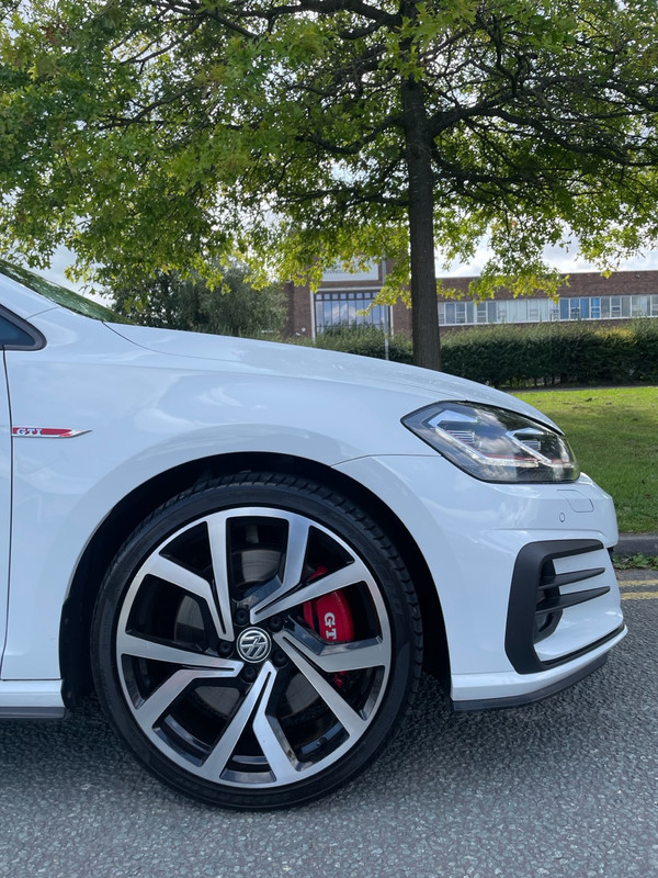

6 days ago I finally made the leap and bought a used mk7.5 GTI Performance. It’s only been a week but I’m completely over the moon with it and have already started doing some light tinkering using OBDEleven. Eventually going to take it to the Green Hell as well! Know the area very well as I grew up around there before moving to the UK.
 I think the front quarter side shot should be classed as NSFW.
