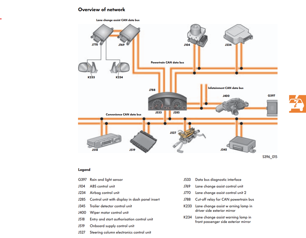

Do you have OBD11? If you do...look for J769 and J770... these are the components according to this VW doc that are needed over and above some other elements....
No mention of Park Assist controllers being part of it
Look at this:

But I have Side Assist fitted, as I have the LED's in the wing mirrors, and it warns me of approaching traffic, so as they go through those elements I'm assuming all is present and correct.

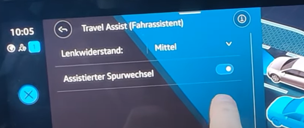

Took a screenshot of the YouTube video I saw, it's in German but using any Translate tool, it appears that "Assisted Lane Change" is an option to turn on. I've seen a second video that only had that one option, the Steering Resistance option was not there. So it must all come down to what Driver Assistance options each car has.
I had Park assist on my previous car, and there was obviously a motor for the steering wheel, as it would spin when parking itself, and also there was a forceful resistance for keeping the car within the lane when driving, which to be honest I don't feel with the Golf. So maybe extra hardware (i.e steering wheel motor) is needed for this feature, or possibly the extra side sensors which you get with Park Assist?
