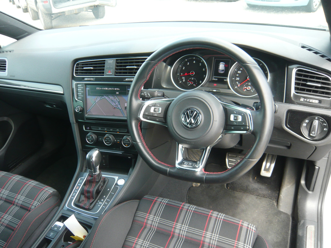

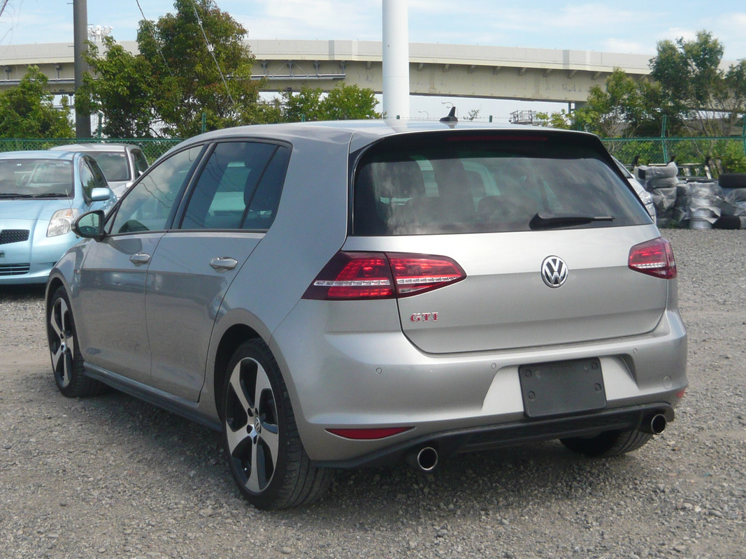

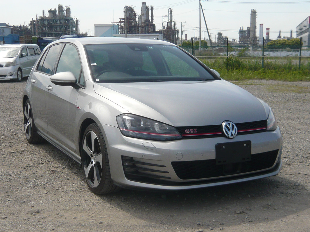

Hello, I recently bought a MK7 from Japan and I think it may have a performance pack but I’m not sure. Can anyone confirm or disprove this from looking at the photos?

Easiest way IIRC is if its got "GTI" on the front brake caliper.
Im sure too a non PP Golf has silver badges front and rear, whereas a PP one has red badges.
So it looks like yours is maybe a PP??
Although these could have easily been doctored to make it look like a PP, see if its got the VAQ diff thats probably the best way of determining.

Also larger chromed exhaust pipes on a 7.5 but not sure about a Mk 7.

OP - original question - superficially judged on the photographs, the badging in fill in red suggests PP.

Maybe look for settings (設定). Next Language (言語),
Bigger problem might be the frequency for the radio as I think Japan only goes to 80mhz

PP has larger Front discs and GTI plague on front calipers, also has VAQ front diff so look down below intake pipe in engine bay and see if can see a unit bolted to side of gearbox or just a driveshaft (if none PP)

Yes mine seems to have bigger tips than those in the picture
