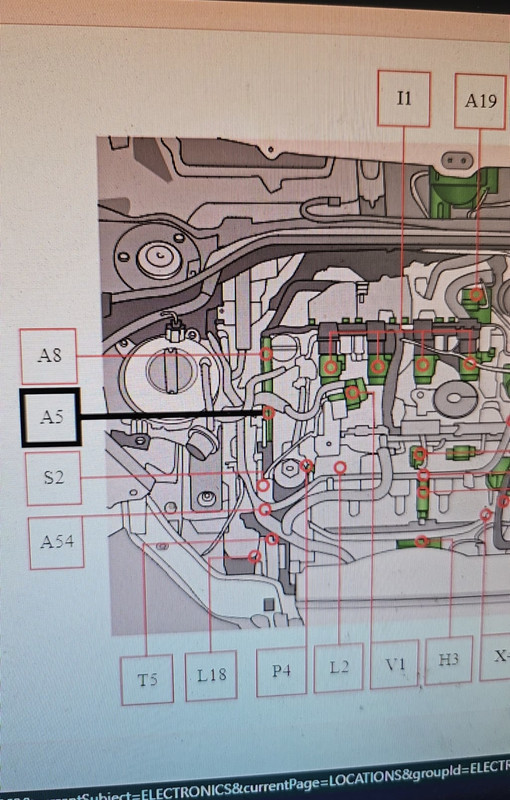

I have checked these two sensors on the diagram attached at bottom of post. Sensor A8 and A5.
I’m pretty sure sensor A5 is the inlet cam sensor (sensor A) ? and Sensor A8 is sensor ‘B’ - the exhaust cam.
There is some oily residue in the area of sensor A8 as it is immediately below the oil filler cap. Perhaps this could be causing some issues with the sensor.
I see what you’re saying regarding the sporadic terminology of the faults.
Also, I’m not sure if this is relevant but the CEL initially came on after I turned onto a very tight, very steep 1st gear turn at a junction. Although just to reiterate the car is running fine and isn’t making any strange rattling noises at idle or when being driven.

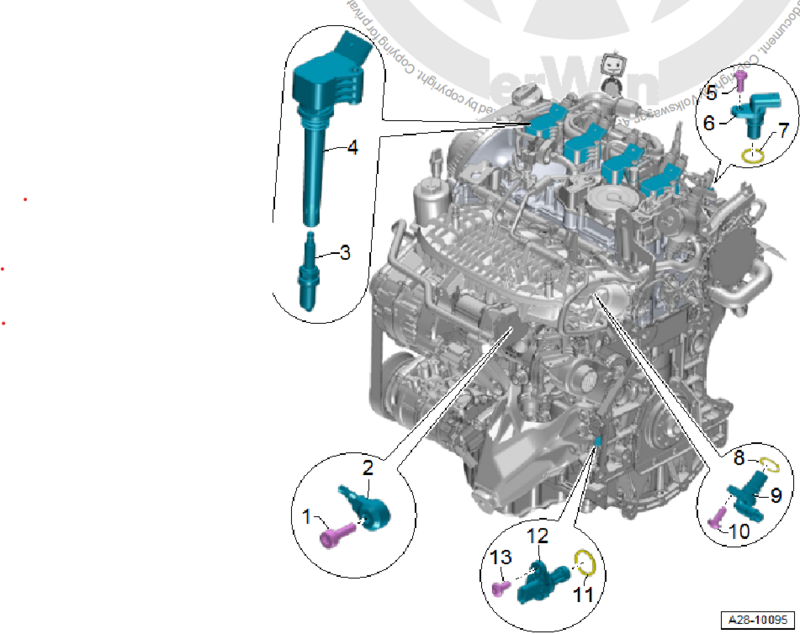

A5 and A8 are the camshaft adjustment valves, not the cam position sensor.
You need to look at the sensor just to the right of coilpack 4, held in with a small torx bolt. (Disregard the number on the picture next to the coil pack, thats for the manual description, thats coil pack 1)
Item 6 in diagram exhaust cam sensor.
Item 9 is inlet cam sensor.
Item 12 is crank sensor.
Item 2 is knock sensor.
« Last Edit: 25 May 2023, 10:22 by madstaff »
Thanks a lot for this, very helpful. Been looking in the wrong place the entire time!

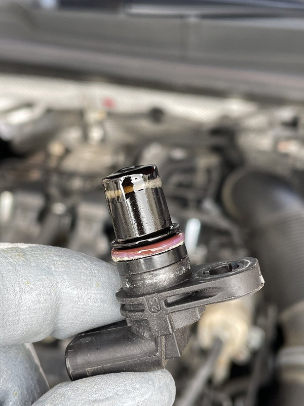

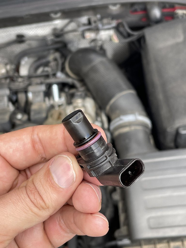

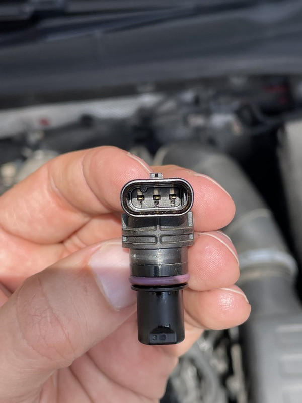

I've had the exhaust sensor (sensor B) out for an inspection and all looks OK. Was pretty stiff to remove once the plug was disconnected so the O-ring is doing its job nicely. Can't see any sign of anything wrong visually. Not really sure how to test it with a multimeter as it's 3 pin - any ideas?
I didn't bother removing the intake sensor (sensor A) as it's a lot harder to get to. Until I can find a way of testing the sensors then getting the intake sensor doesn't make much sense.
