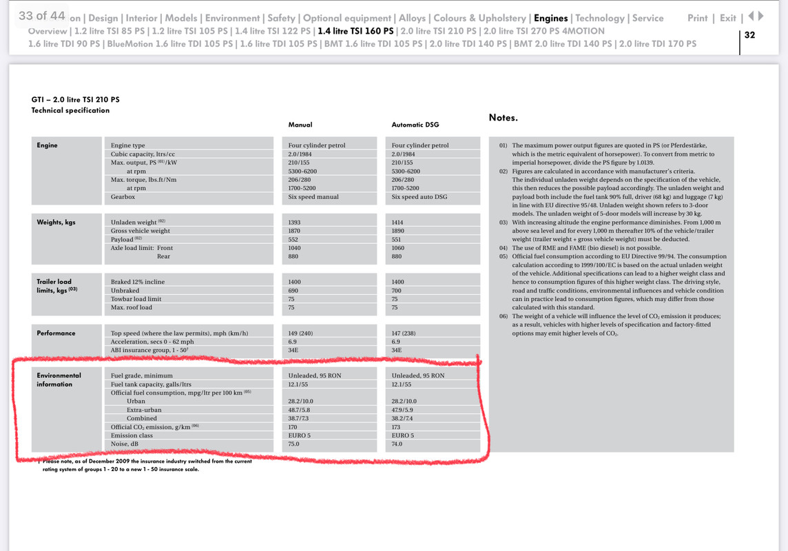

Below are VW’s ‘official’ fuel consumption figures for the mk6 GTI from the December 2010 brochure. Bear in mind that the official figures tend to be somewhat optimistic and are rarely - if ever - achieved in normal day to day driving. Link to the brochure; https://www.volkswagen.co.uk/assets/common/pdf/brochures/golf-vi-brochure.pdf
