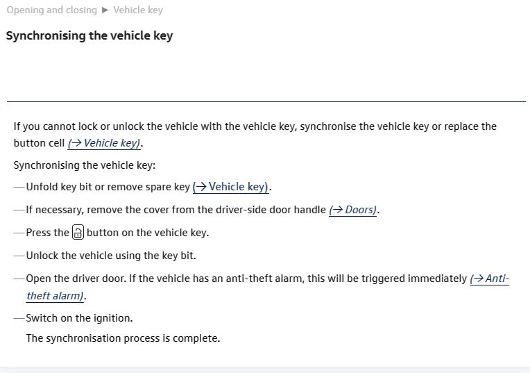

Assuming the battery you've changed isn't a dud, have you tried re-syncing the key?

Ok, just tried that, alarm went off, put key in and turned ignition, no joy. The key light doesn't light either, would be odd if both the existing battery (which was still working in the fob till I swopped it) and the new one were now dead, the one I put isn't that old either as I use the same type for heart rate monitors.
