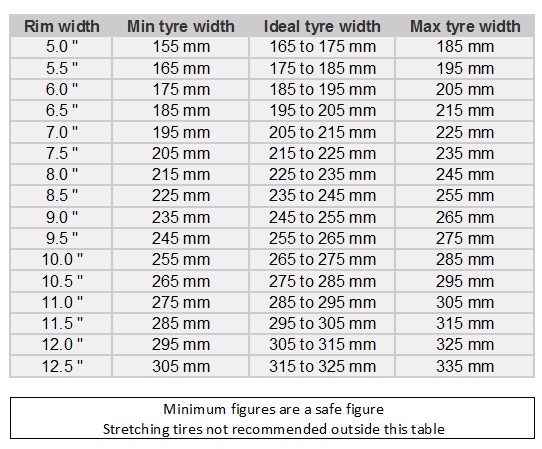

The table below shows the min, max and ideal tyre widths for different wheel widths. Based on the table contents, a 225/35 R19 would be OK on an 8.5J alloy but if the tyres don’t have particularly good rim protection, there’s an increased risk of kerb damage when parallel parking. If you were to go wider than your existing 225/35 R19 tyres, the sidewall height will increase, resulting in the overall diameter and circumference of the new wheel tyre being larger than OEM which will result in your speedo reading incorrectly.

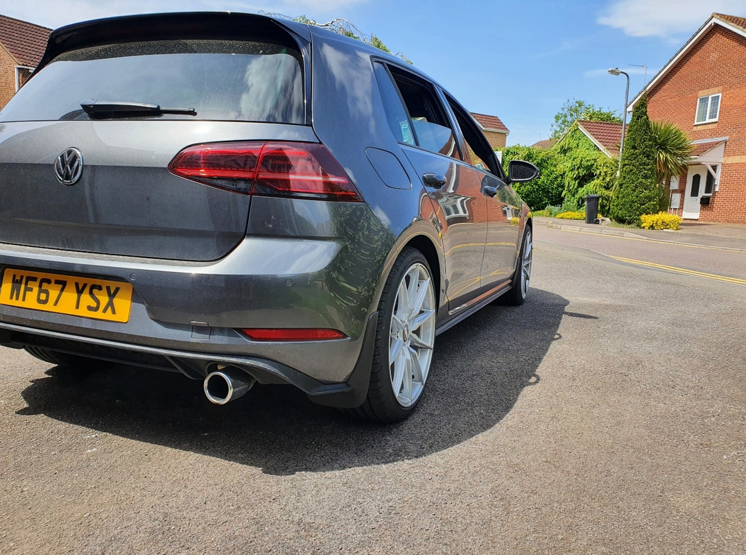

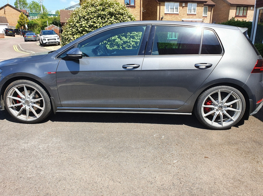

Might be useful for reference. Some pics of mine on Bola b16 235/35/19 19x8.5j ET45.
Have had no issues whatsoever with the wheel size or rubbing etc. Just a slight drop in mpg likely due to the wider wheels!
