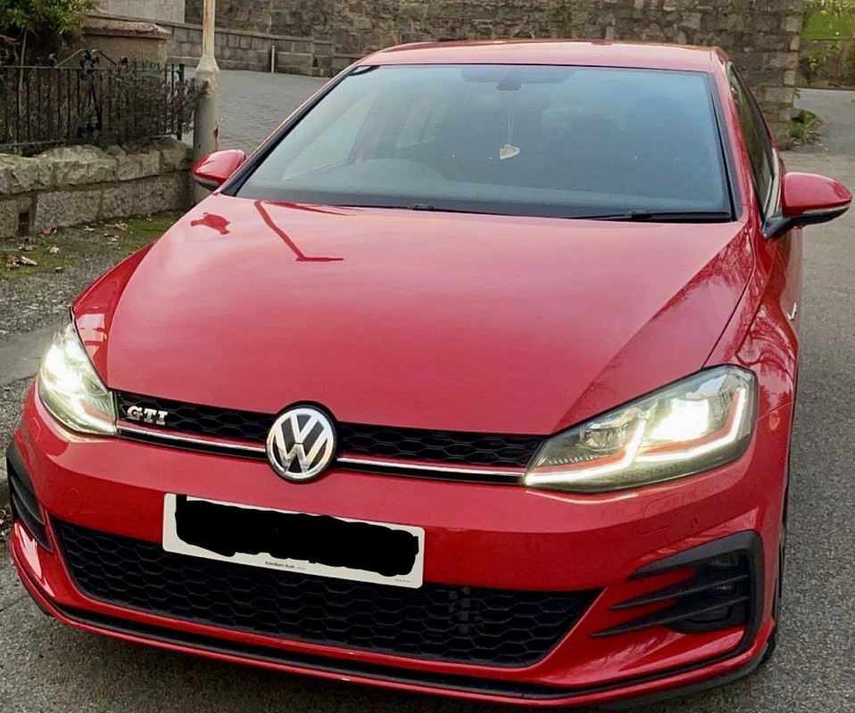

Sometimes this can happen if the sensor is obscured.
Does the car have a standard oblong number plate or does it have one of the types with a small section sticking out from the bottom with the dealers name on it?
My car came from Cazoo, and they fitted one of their plates on the front with the small piece sticking out from the bottom saying Cazoo. I never got the brakes come on automatically, but I did occasionally get random front collision warnings.
I cut the extra piece off with a band saw at work and I haven't had the problem since.
Golf GTI 7 PP
BMW M140i
Offline fairmer
  • Posts: 7
Re: NEWBIE Desperate for help
« Reply #4 on: 20 September 2022, 14:21 »
Symonh2000, wow, that sounds incredible, I will have to check when i get home and see.
I can't comment before checking it, so need to have a look. Appreciate the tip though.
EDIT to add: She just sent me a pic, and the bottom of the number plate hangs down past the bottom of the bumper, if that makes sense.
Will certainly try and get a narrower plate to try that.

The radar for cruise etc, is behind the VW badge on a 7.5, so nothing to do with the number-plate size or position.
You could try and give the badge a gentle clean just to be sure theres no dirt on there triggering the warning.
