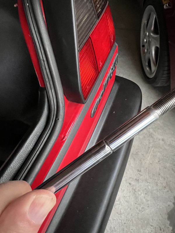

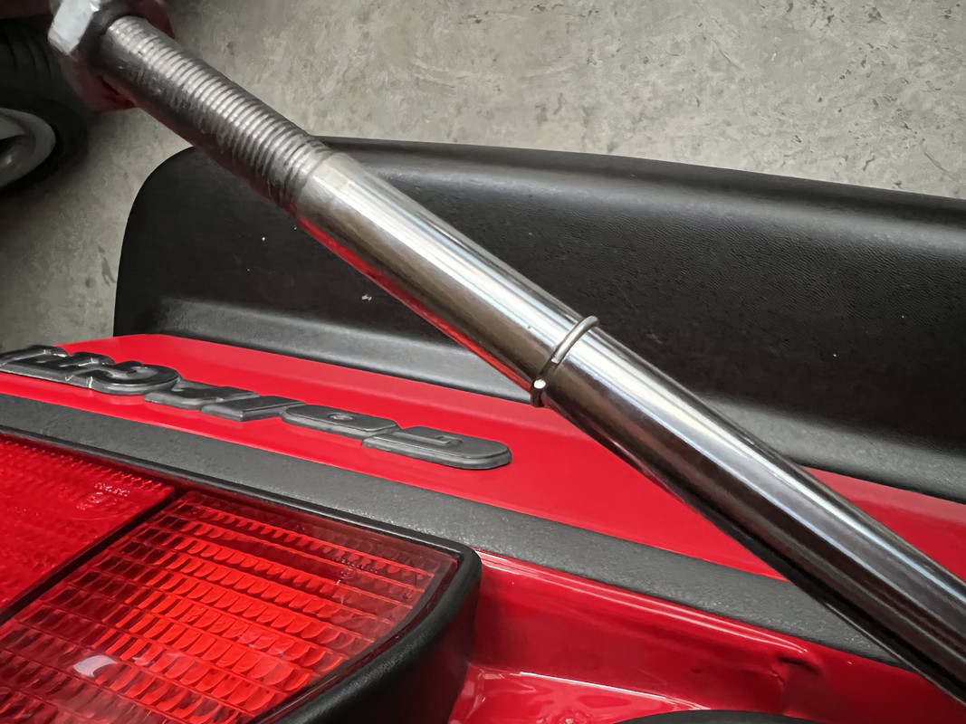

Photos below.
Photos show shock absorber with and without the small clip.
Here are some photos.

Snap ring i think they're called.
Have a measure up and perhaps a supplier like this may have something.
https://simplybearings.co.uk/shop/Bearings-.-Round-Wire-Snap-Rings/c3_4474_4527/index.html?selection=Round+Profile+Wire+Snap+Rings

Thanks Madstaff,
I also posted the same question on FB and was given exactly that the same link and ordered them this afternoon.
Thanks for the help.
Cheers
