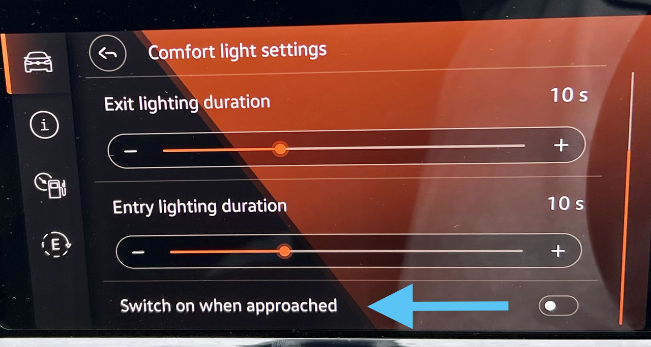

Can’t remember exactly. In vehicle settings under “lighting” I’d say.
Offline massimo23
  • Posts: 59
Re: IQ Lights come on 5mins after car locked
« Reply #5 on: 15 May 2022, 19:28 »
This setting😉:
