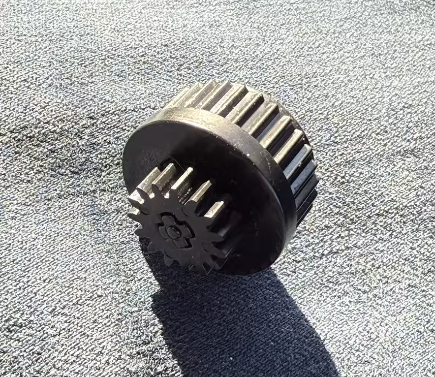

« Reply #46 on: 20 March 2025, 17:53 »
I or my mechanic still can't get the bottom of the issue, of the main heat coming out of passenger side, and it being like warm drivers side.
Found this today in the footwell, maybe it's fallen off something behind the dash?

« Reply #47 on: 21 March 2025, 09:09 »
That looks like the little cog on the glovebox arm that slows down it's opening.
I guess you or your mechanic  have had the glove box swung all the way down as part of the investigation.
This cog can fall off if you don't unclip the arm properly before swinging it all the way down.
I would say you problem sounds a lot like an actuator problem.
If there is hot water at the matrix but not at the vents then I would think the control flaps that mix the hot air from the matrix with the cold air intake, to get the desired temp, and then distribute it are not effectively working.
Diagnostic scans will only show electrical problems with the actuators, if the actuator has become disconnected form the flap then it will move as per the electrical commands but the control flap will not.
Only my 2p worth, but hope it helps.
good luck!

« Reply #48 on: 21 March 2025, 13:29 »
Thanks, yes I thought it might be from glovebox!
We already replaced the right temperature flap motor (VW part 5Q0907511K) and that stopped the clicking noise in the dash and cleared the fault.
Actuator sounds probable, but we can't see any issues with the other ones that are visible, so it must be deep in the dash. Hence we are a bit stumped about how to get to it, unless if you take about the headunit you can get to it? Anyone have an exploded view of the that area?
