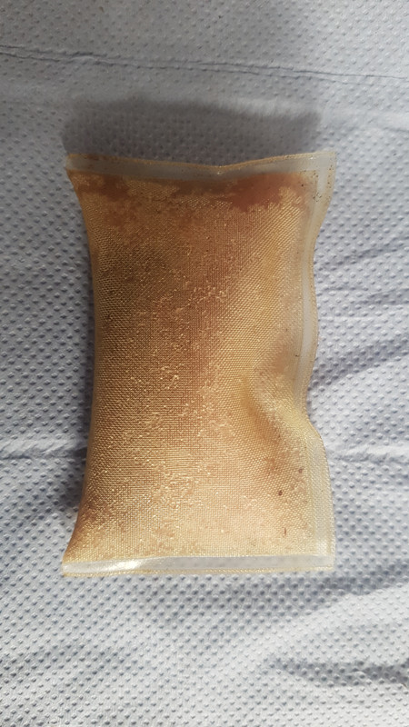

My Clubsport has expansion tank 5Q0 121 507 G and upon closer inspection has the dreaded tea-bag.
I mean, had a dreaded tea bag.
10 mins later and it's out, fortunately no signs of tears to the bag.
