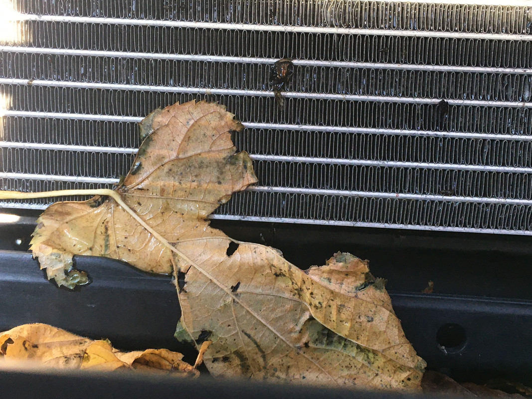

Good morning, can anyone tell me if there is a simple way to remove leaves that have got in past the lower grill and now lay against the radiator. All simple suggestions invited!!!!!

Use a small litter picker, also would suggest some sort of mesh in front of grill as the AC condenser is an £800 repair job (had to get mine done a couple of months ago. As you can see from the pic it is a stone magnet and the holes on the Mk8 are bigger than on my Mk7.5

I was looking to put the mesh on the inside but you are correct it is a bumper off job and I did not want to go that far so some 6mm black alloy diamond mesh from ebay on the outside and some ty raps and cheap and cheerful fix and you would not really notice unless you were looking for it.

I’ve got some really long nosed pliers I use,the remnants I just blast with a pressure washer.

What baffles me is that although the honeycomb holes are big enough to get a wash mitt into (their bonus point) the openings are much smaller than the massive maple(?) leaves nestling up against my aircon rad. How the hell they fitted through there I have no idea.

Extension on the vacuum hose works for me. :whistle:
