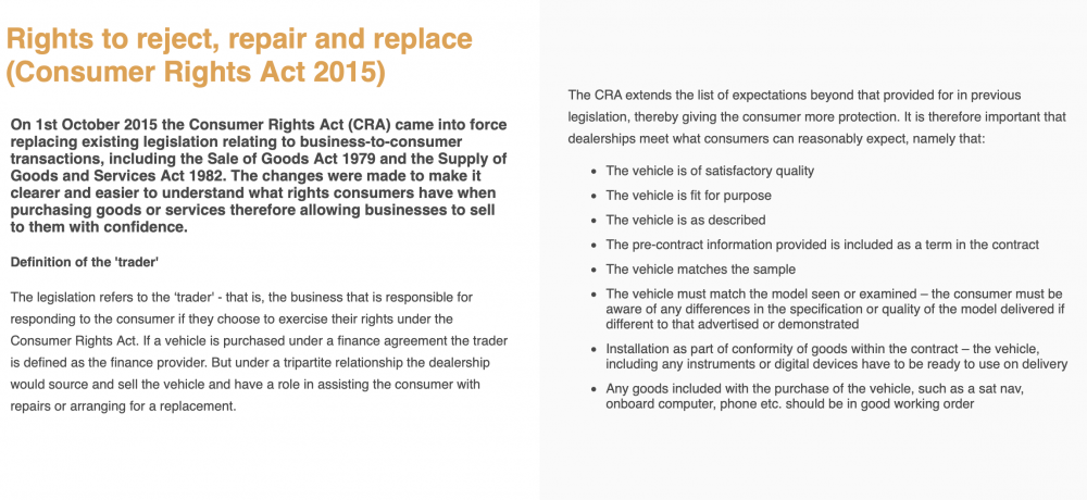

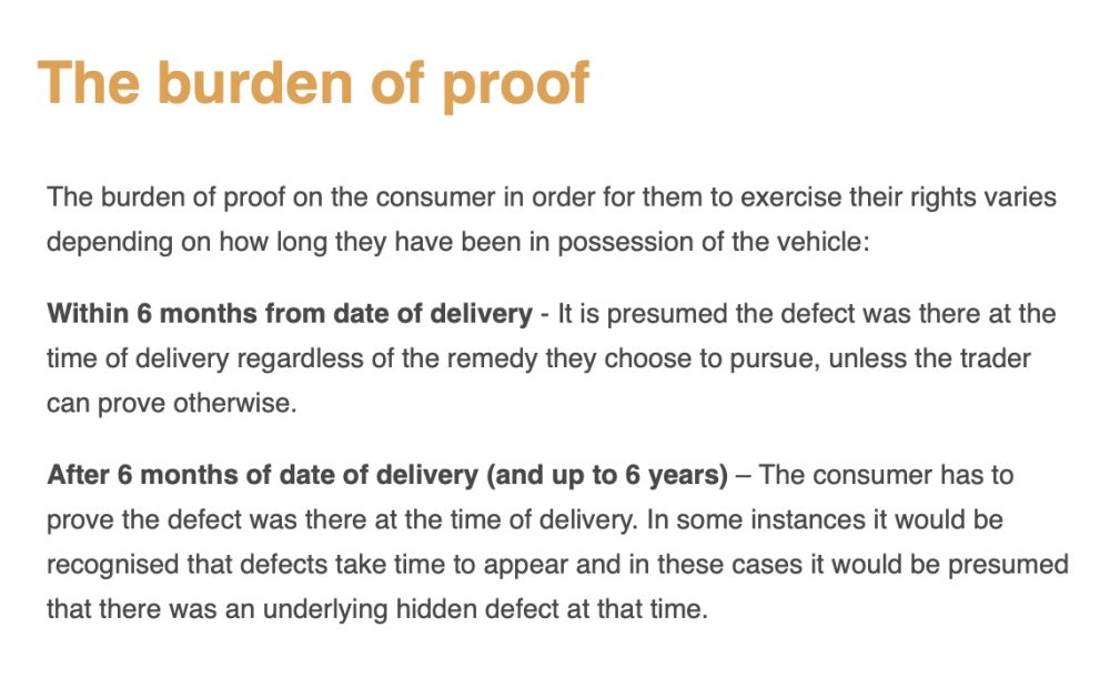

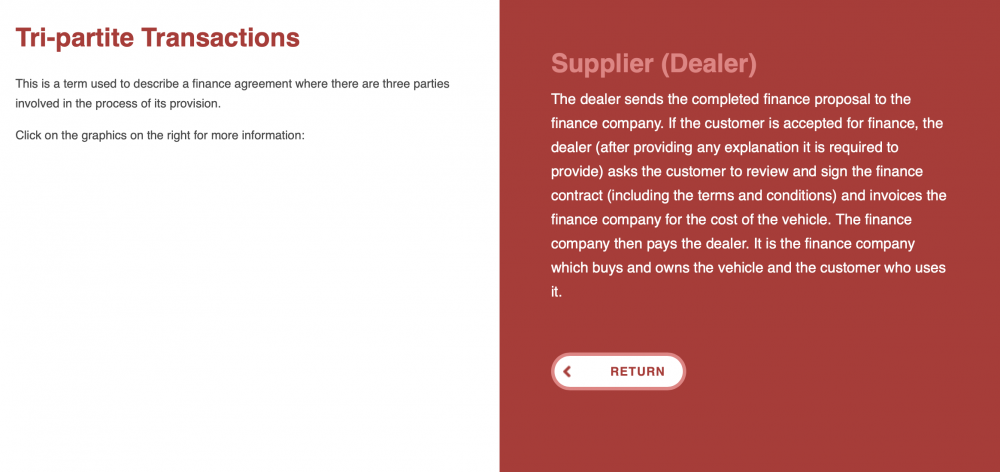

The important legal stuff is the Consumer Rights Act.
Contact VW Financial Services ASAP (if the car is finance through them, or any other finance company if used) - if financed, they are the legal owner of the car, and not you - your 6 months from taking delivery in May will run out soon - rejection should be easier in the first 6 months
if not financed through a finance company, then the contract is between you and the dealer - you would write to the dealer principal requesting rejection
